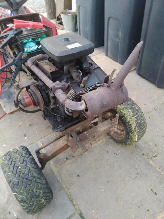

Dan.gerous 2,696 #28 Posted July 24, 2020 Does anybody know the name of that engine? Need to start looking for parts but not sure what its called and Briggs seem to have a lot of similar stuff out there but its V twin Vanguards or whatever. Share this post Link to post Share on other sites

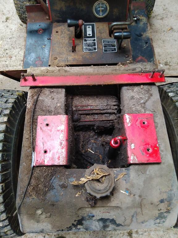

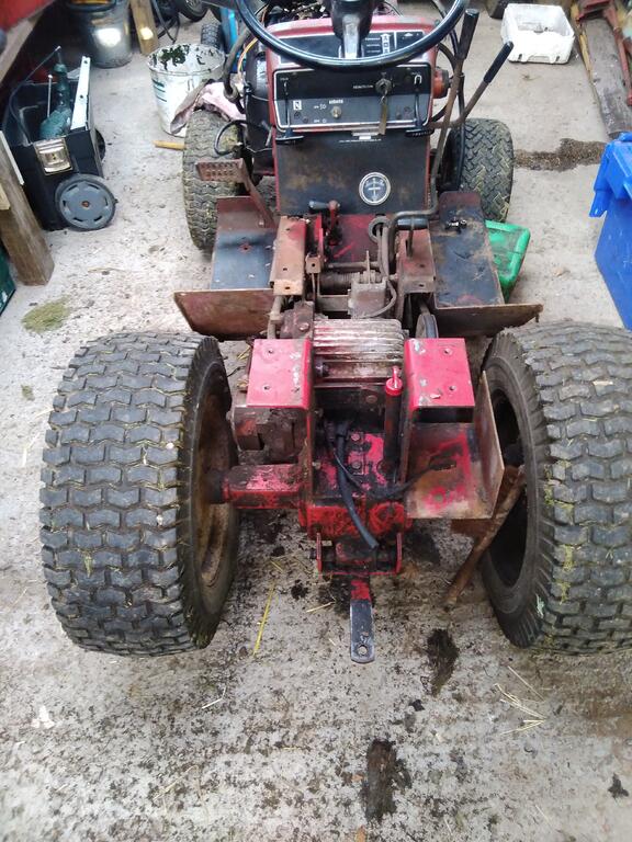

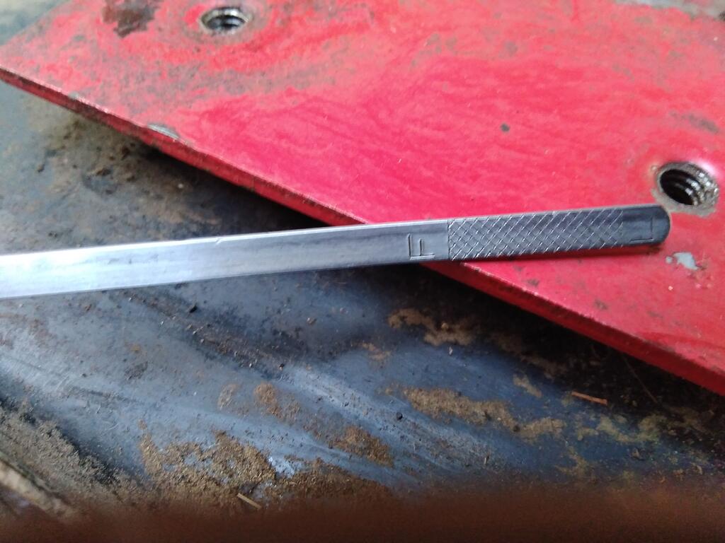

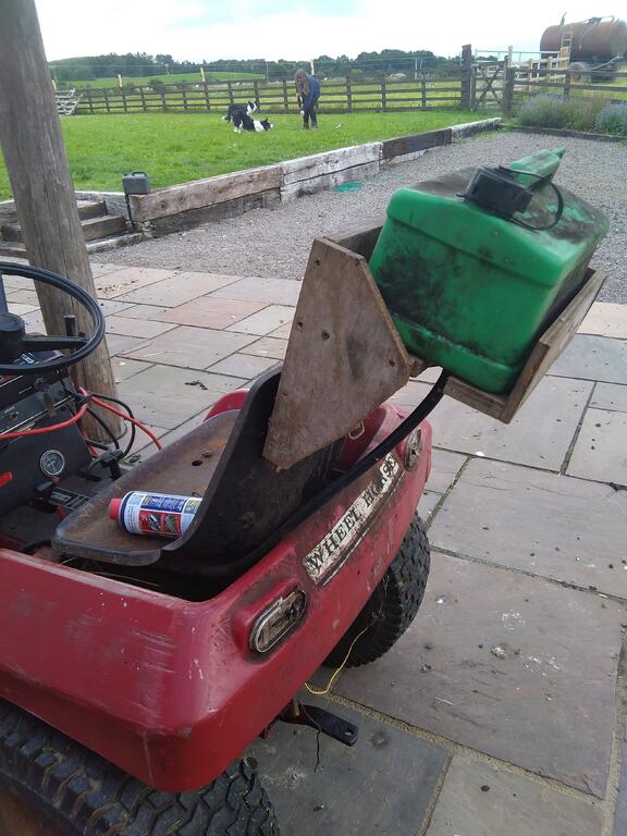

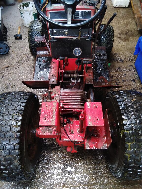

Dan.gerous 2,696 #34 Posted July 27, 2020 Spent a few minutes on the c161 - named "Pete" after the engineer who owned it last. Removed the seat and rear unit to start cleaning. A lot of debris in there! And the usual coating of oil that has converted this entire vehicle. Every cooling fin on the sunstrand was blocked and the gearbox casing - can't have been doing it any favours. Dipped the hydro, not much oil in there! See the picture ☹️ you can see it down the tube but it didn't register on the dipstick. Had a job getting the tank off as one of the underside bolts just spins. Had to remove the bracket in the end to get it off. He had put that fuel tank up behind the seat due to fuelling issues, but I notice the original pipe was still in place and it was in bad condition - that was probably the issue rather than the fuel pump. Anyway, a little progress is better than none 😊 1 Share this post Link to post Share on other sites
