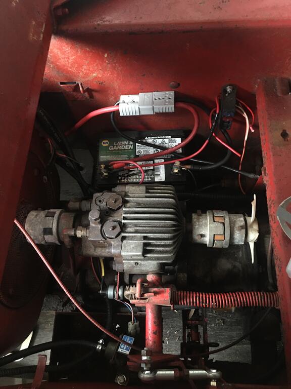

19richie66 17,926 #52 Posted January 2, 2021 I have them on my Hesston so I can disconnect the battery. I plan on making a trickle charger attachment that I can plug into them all. Eventually, all my tractors will have them. 3 1 Share this post Link to post Share on other sites
ebinmaine 79,510 #53 Posted January 2, 2021 6 minutes ago, 19richie66 said: Eventually, all my tractors will have them. Might be an add-on we start doing too. Share this post Link to post Share on other sites
19richie66 17,926 #54 Posted January 2, 2021 One half will eventually get solidly mounted and the other half comes out with the battery. 👍 3 1 Share this post Link to post Share on other sites
ebinmaine 79,510 #55 Posted January 2, 2021 1 hour ago, 19richie66 said: One half will eventually get solidly mounted and the other half comes out with the battery. 👍 Same thought I had. Could be handy. Especially for machines not often used. 3 Share this post Link to post Share on other sites
Maxwell-8 4,371 #56 Posted January 2, 2021 11 minutes ago, ebinmaine said: Same thought I had. Could be handy. Especially for machines not often used. They are 120 amps MAX, but can handle more amps for shorter periods. 1 Share this post Link to post Share on other sites
ebinmaine 79,510 #57 Posted January 2, 2021 6 minutes ago, Maxwell-8 said: They are 120 amps MAX, but can handle more amps for shorter periods. Yep. K341 starter draw can be 125 amps or so for short periods. It would be fine. 2 Share this post Link to post Share on other sites
DennisThornton 4,773 #58 Posted January 2, 2021 1 hour ago, ebinmaine said: Yep. K341 starter draw can be 125 amps or so for short periods. It would be fine. I WAS concerned about that! But QUICK starts are one thing, long drawn out winter starts could be different. 1 Share this post Link to post Share on other sites
19richie66 17,926 #59 Posted January 2, 2021 Used them on winches at work with hard pulls and never had an my issues. 2 1 Share this post Link to post Share on other sites
ebinmaine 79,510 #60 Posted January 2, 2021 17 minutes ago, DennisThornton said: I WAS concerned about that! But QUICK starts are one thing, long drawn out winter starts could be different. They take a decent sized battery cable so I wouldn't be any concerned. 1 Share this post Link to post Share on other sites
Tractorhead 9,217 #61 Posted January 2, 2021 I would have no doubt that they even last 160Amps for short times. As long as the Contact Surfaces are clean and greased, they will last. only the care of the contact surfaces i see as an trouble zone, that is very important in my opinion. Btw. This connectors are available in different sizes up to 500Amps. Have seen shortly one on an RV that was in our Office, while a other Company used that connector for a external Charging Connection at the outside for a Sterling 200A Charging booster long term over that. It was a changable Platform RV where you can use the Truck allone or with the House on as RV. To upgrade our Electric this Company mounts the Connector as changable option, but they didn‘t told the customer they have to keep them clean and greased. That runs few years without less problems, but they didn‘t take care on that connector, so it begins to rotten down and missed it’s Ground connection. A nearly burning RV in our Office was a result of this missed care when our customer arrived our Office. 1 Share this post Link to post Share on other sites

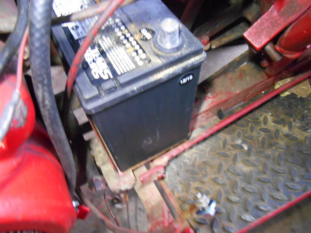

ohiofarmer 3,439 #63 Posted January 6, 2021 Lots of good info here. Since this started out as a battery thread, i will share the largest conventional battery that will fit the space of a battery mounted low on the frame. The mighty C-160 has a free donor battery that was allowed to discharge from sitting too long. It was in a Mazda Miata about 9 years old [the car] Anyway, with a build date of 12/19 and a CCA of 500 , this battery sure should have the onions to crank a c-160. i am not so sure that a battery on coil engine with an old fashioned rectifier is not better served with a lead acid battery anyway. That viewpoint is what a contingent of bike guys have been saying , but that is internet opinion and I am not taking a position on that. This battery I have is a post style, so I will have to use post to commercial adapters to make it work. As the picture shows, that battery completely fills the battery box 1 Share this post Link to post Share on other sites
ebinmaine 79,510 #64 Posted January 6, 2021 1 hour ago, ohiofarmer said: battery Do you know what BCI group # that is? Share this post Link to post Share on other sites
ohiofarmer 3,439 #65 Posted January 7, 2021 (edited) 7 hours ago, ebinmaine said: Do you know what BCI group # that is? It is a 51R Super Start 51REXT Not cheap by any means. I have bought Red tractors for less Edited January 7, 2021 by ohiofarmer 1 Share this post Link to post Share on other sites
ebinmaine 79,510 #66 Posted January 7, 2021 15 minutes ago, ohiofarmer said: It is a 51R Super Start 51REXT Not cheap by any means. I have bought Red tractors for less Yepp. 51 is what's in Cinnamon. I got it at the salvage yard. Getting a bit slow to rumble so I need another. And one for the Charger.. Share this post Link to post Share on other sites
