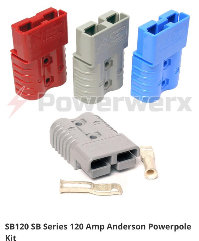

ebinmaine 80,765 #44 Posted January 1, 2021 1 hour ago, TC10284 said: . Just need to find a way to quickly connect/disconnect it. 1 hour ago, Vurge said: put Anderson type plugs on the battery and tractors. 1 Share this post Link to post Share on other sites

19richie66 17,936 #49 Posted January 2, 2021 (edited) Anderson plugs are great. https://powerwerx.com/anderson-sb-connectors-sb120-120amp Edited January 2, 2021 by 19richie66 1 1 1 Share this post Link to post Share on other sites
ebinmaine 80,765 #50 Posted January 2, 2021 38 minutes ago, 19richie66 said: Anderson plugs are great. https://powerwerx.com/anderson-sb-connectors-sb120-120amp Agreed. I got similar ones of a different make and still commercial grade to use on some things here. Certainly appears to be very heavy duty and easy to disconnect for convenience or emergency. 2 Share this post Link to post Share on other sites
