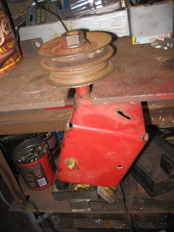

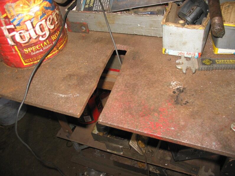

daveoman1966 3,841 #4 Posted July 18, 2020 I have a 3/8 thick steel workbench top...cut a 1" slot in it expressly for removing the Mule Pulleys. 1) Loosen nut to be flush with end of pulley shaft. 2) Slide shaft into this 1" wide slot. 3) Beat the hell out of the shaft nut until the pulleys break free. 4) Hasn't failed me yet...and haven't ruined any pulley shafts either. 7 Share this post Link to post Share on other sites
hotajax 226 #5 Posted July 19, 2020 Fixed. I got the inner bearing off. Wheel puller absolutely useless. Getting that pulley off was a tussle. But I did something with my vice like DaveOMan does with his workbench. A 14" ball pein hammer and develops some pretty good mass at removing parts. What did they say in the Navy? Get a bigger hammer. I am very appreciative of the tips I got from people on fixing it. 1 Share this post Link to post Share on other sites
