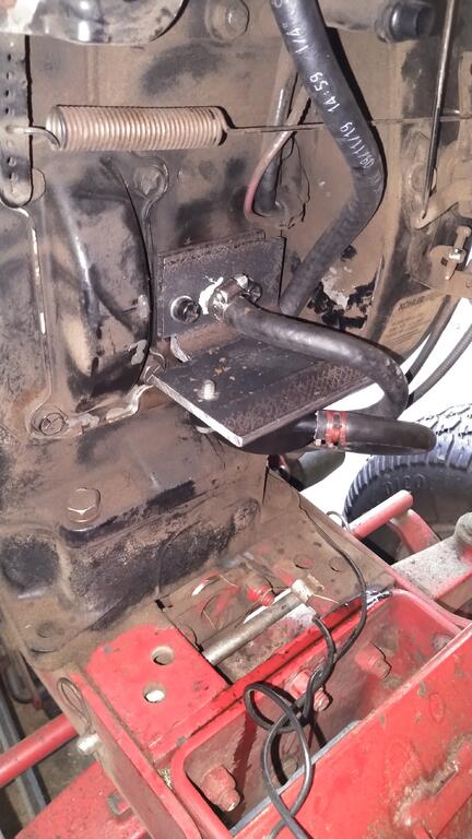

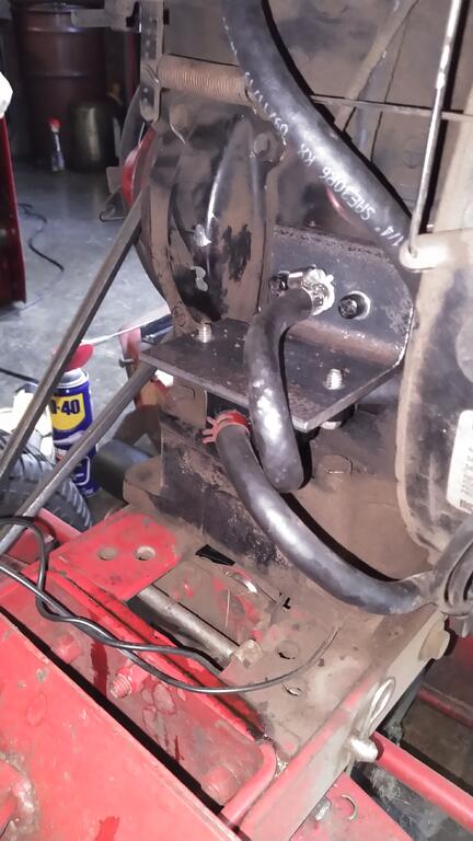

Bill D 3,193 #28 Posted July 22, 2020 Hi Ron, There is a small chance that you have a bad pump. If it's not holding a prime after it sits for awhile that would cause your starting issues when cold. Cleaning and rebuilding the carb and changing the shut off valve with it's built in filter would be my first choice. Do you use non ethanol fuel? My tractors seem to start better on it. These are pictures of my first bracket design that I used on my dad's tractor. Bill Share this post Link to post Share on other sites
