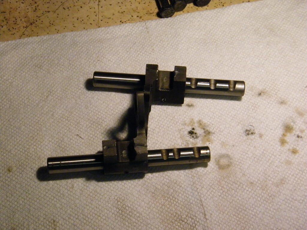

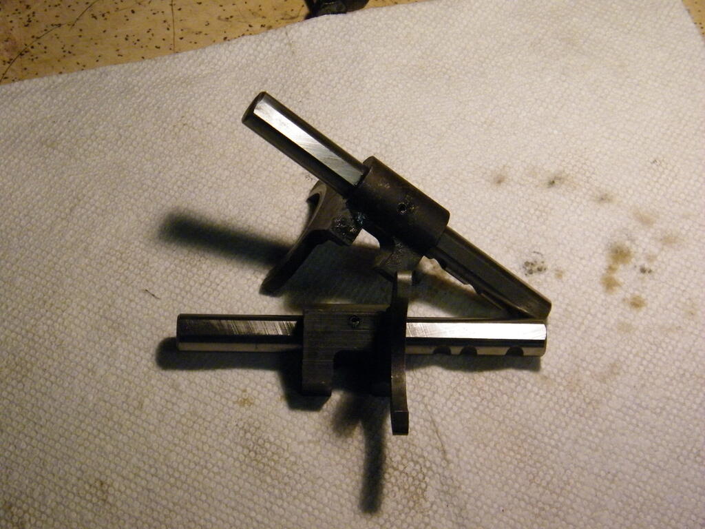

stevasaurus 23,325 #5 Posted July 18, 2020 You have 3 options... 1. use the 5025 and make sure you come to a complete stop before shifting transmission. The suction happens when shifting real fast between like 2nd and reverse or vise versa. 2. open both transmissions and swap the rails and forks. 3. Use the 5053, but take a look to make sure the commando did not have longer axles. Actually, there is a 4th option...open the 5025 and grind a flat along the length of the existing shift rails. round ones flat ones Share this post Link to post Share on other sites
