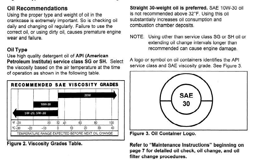

rjg854 12,727 #4 Posted July 16, 2020 Try using a straight weight oil, as recommended by Kohler during the warmer months like 30w. See if that doesn't help with the smoking issue before you tear anything apart. You say you're using 10-40 , they call for a multi-grade for colder weather. 5 Share this post Link to post Share on other sites
953 nut 63,578 #6 Posted July 16, 2020 A Kohler engine with only 700 hours of operation on it shouldn't bee in need of a rebuild if it has had regular oil changes every 25 hours of operation. As Randy said, you should be using 30 rather than 10 W 30. Also, be sure you are not overfilling the oil. 2 Share this post Link to post Share on other sites

pfrederi 19,501 #16 Posted July 16, 2020 The owners manual specifically recommends AGAINST 10w-30 above 32 degrees. Noting Excessive oil consumption.... 3 Share this post Link to post Share on other sites
