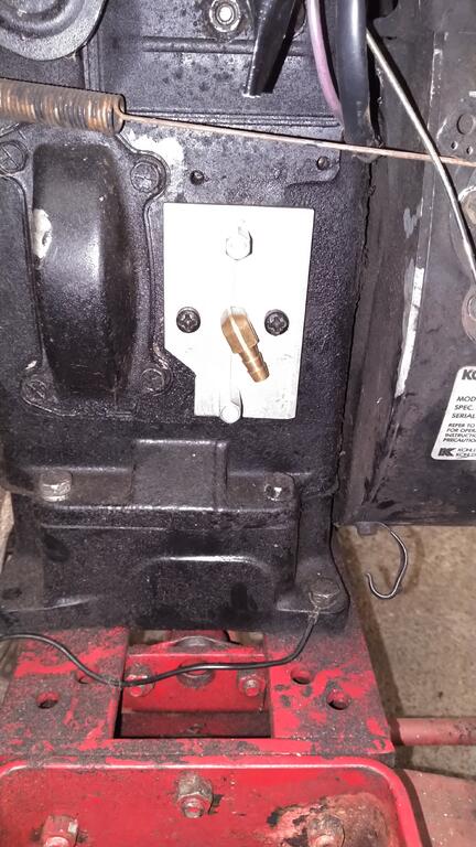

Bill D 2,499 #4 Posted July 15, 2020 The pump is a Briggs pump. The mounting plate is stainless steel. I have since found a Kawasaki pump (P/N 49040-7008) that has the inlet, outlet and pulse lines in better locations. Bill Share this post Link to post Share on other sites

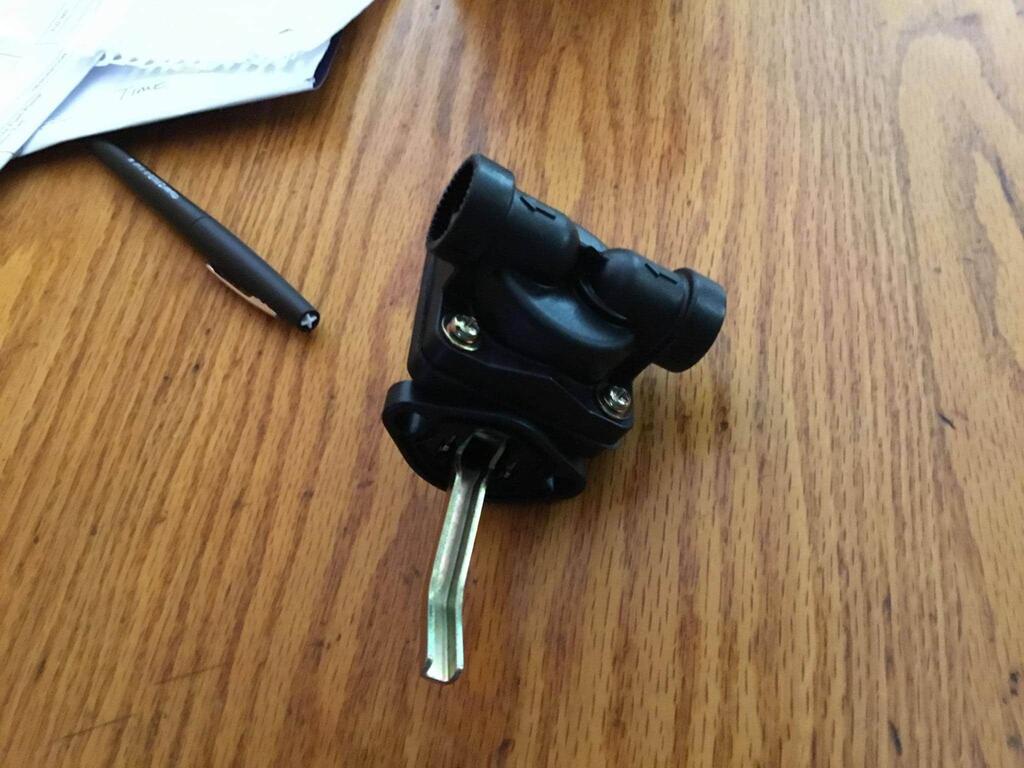

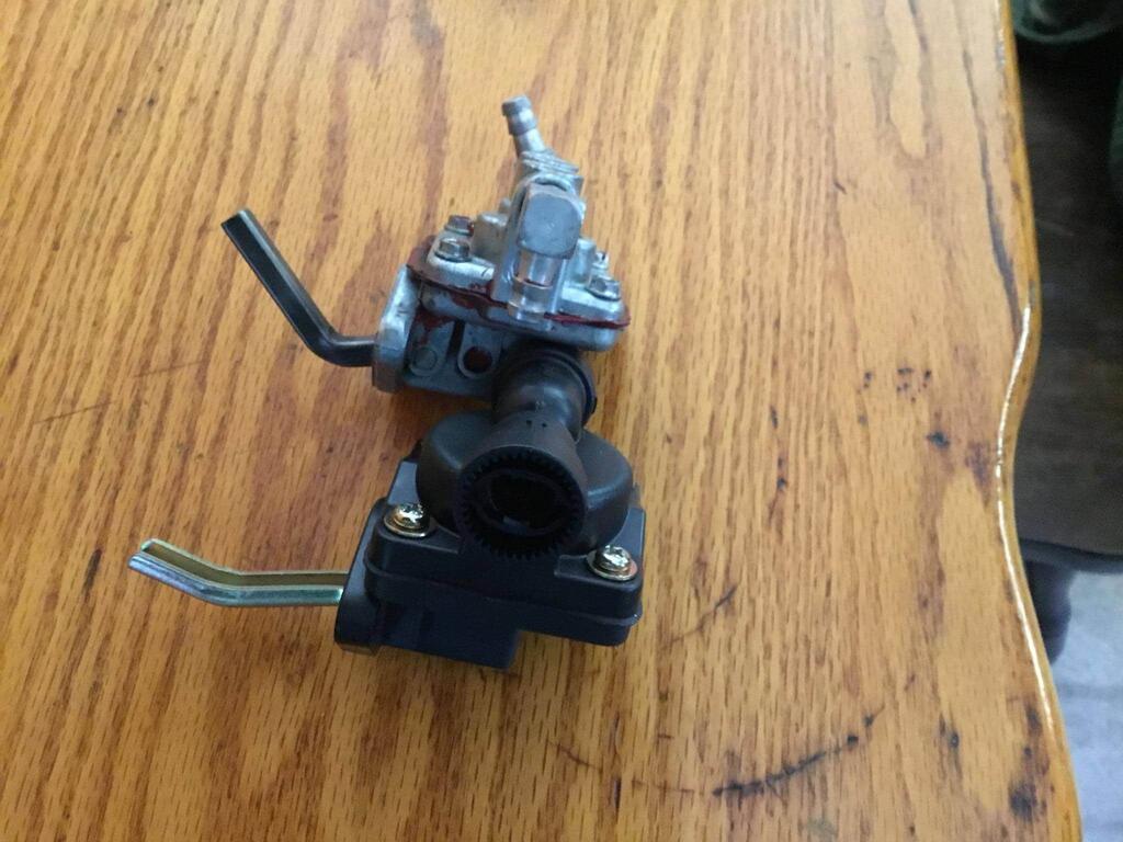

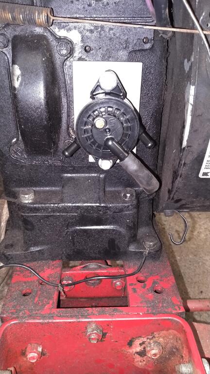

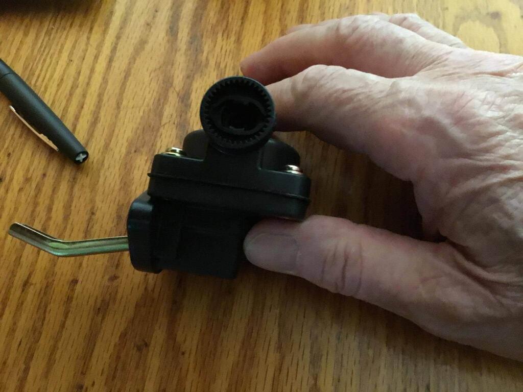

12Horse Paladin 1,038 #5 Posted July 18, 2020 So... My Dad bought 2 pumps; was told they were oem n would fit. Cant say they look thatway, to me. What say you all? Share this post Link to post Share on other sites
pfrederi 19,447 #6 Posted July 18, 2020 They will work. you need to follow the directions using the big E clip to place and adjust the elbows. Share this post Link to post Share on other sites
Bill D 2,499 #7 Posted July 18, 2020 The lever on the plastic pump is wrong for the K/M series. The metal body pump on the back is the K/M series pump. Bill Share this post Link to post Share on other sites
953 nut 63,539 #8 Posted July 19, 2020 Don't know, the lever looks like it would be for a K Twin. Share this post Link to post Share on other sites
Bill D 2,499 #9 Posted July 21, 2020 I think the plastic pump is for a KT/M series twin. The metal pump is the K series pump. Bill Share this post Link to post Share on other sites
