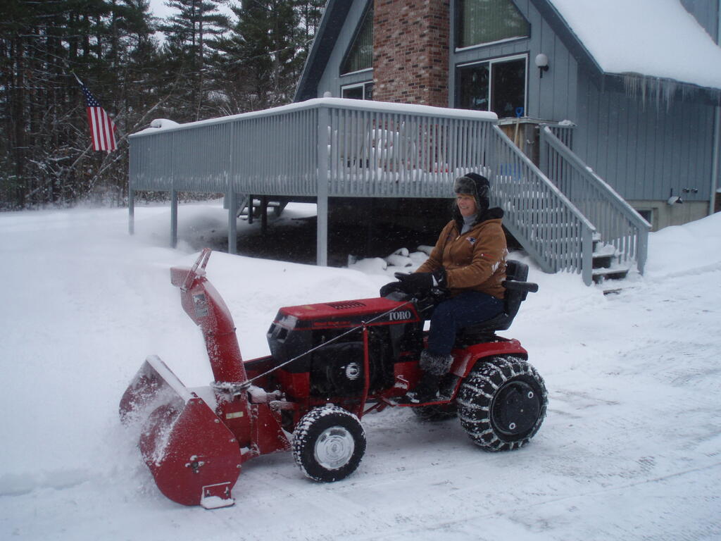

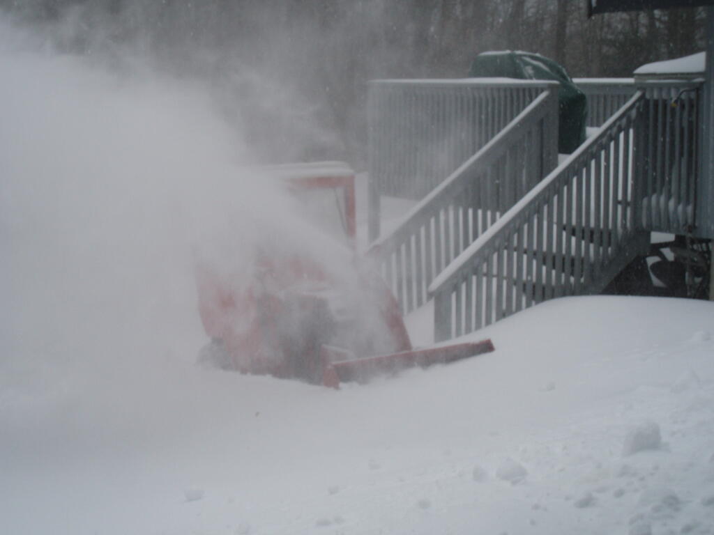

JCM 10,763 #6 Posted July 13, 2020 Great tractor in all 4 seasons, even my better half can handle it. 4 1 Share this post Link to post Share on other sites
