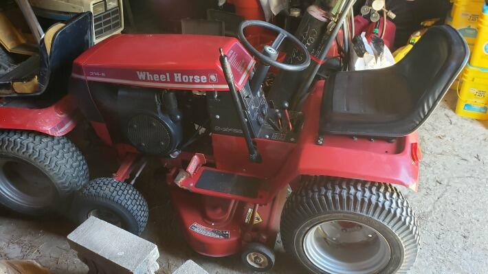

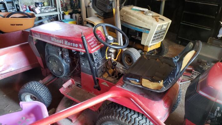

Ed Fox 20 #10 Posted July 12, 2020 (edited) Ok, luckily a super simple fix. Terminal had fallen off the PTO switch. Not the easiest place to try to fit big hands into but I was able to get it back on without having to take anything apart. Thank you for all of your help and Ill post pics of my two wheel horses below this post.. Kindest regards Ed Edited July 12, 2020 by Ed Fox Share this post Link to post Share on other sites
