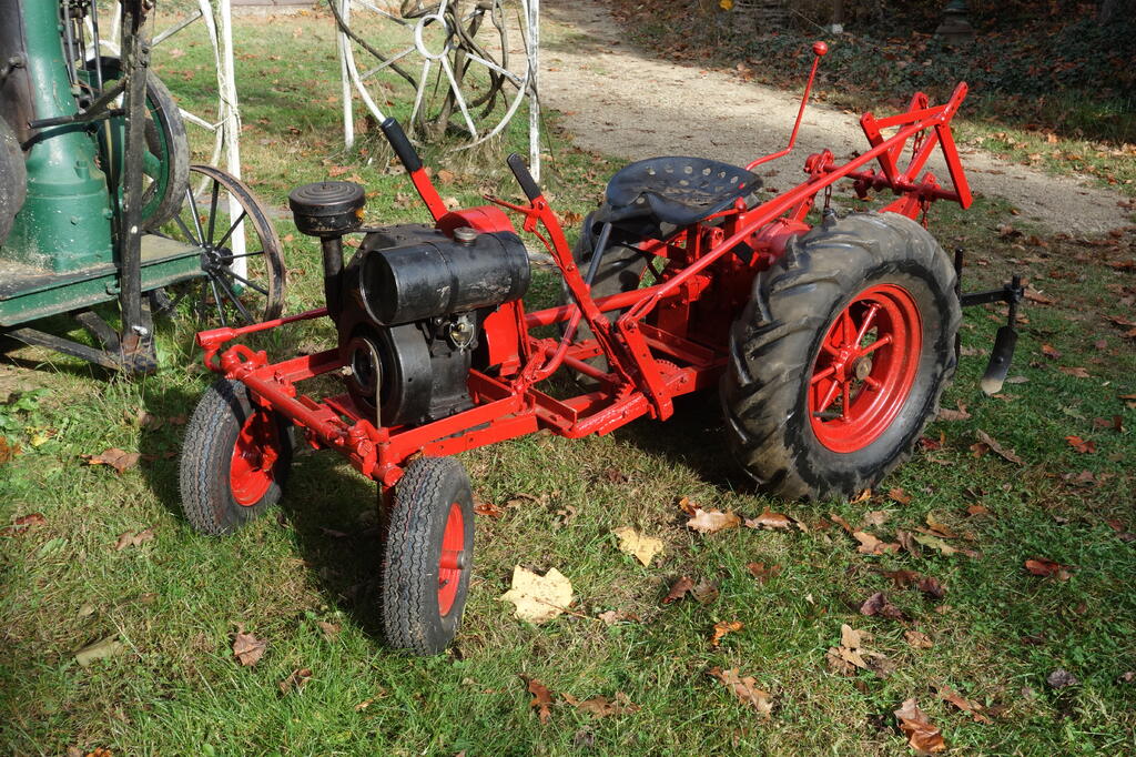

oldiron613 590 #27 Posted July 9, 2020 Shaw initially built wall-behind tractors which they then evolved into garden tractors similar to a number of company's approaches in that pre-ww2 time period. Generally, they were larger that most garden tractors by today's standards, but similar in size to the early Pond, Gibson, Speedex and other truck farming, large garden tractors of that period using alot of recycled automotive parts. Shaw did get into smaller size mowers in the 1950's while still offering the larger garden tractors and then eventually sold out to Bush Hog in the early 1960's. The R6 model pictured is pretty modified from original with the larger 2 cylinder engine and then the lengthened hood to cover it. Originally the R6 was powered by a single cylinder Briggs ZZ engine, similar to what Speedex used in the model B tractors pictured. 2 Share this post Link to post Share on other sites

oldiron613 590 #30 Posted March 9, 2021 On 3/6/2021 at 9:55 PM, PetesPonies1 said: Were these Ford Banjo type rears? And did they have gear reduction, ala a Power King and others? What transmissions and steering where used? The term Ford "Banjo" rear end usually applies to the model A and 30's Ford rear differentials (used on the pre-1962 Economy/Power Kings, Wheel Horse Ride Away Sr, etc.). The rear end is these Speedex model B's are actually, earlier, model T rear differentials. Share this post Link to post Share on other sites

Kevin Beitz 26 #32 Posted August 29, 2025 So.... Tell me what I got... My tranny is BEHIND the seat... 1 Share this post Link to post Share on other sites
953 nut 69,563 #33 Posted August 29, 2025 1 hour ago, Kevin Beitz said: Tell me what I got... My tranny is BEHIND the seat.. From what I can see it is probably a home built using the transaxle from a Standard Twin walk behind garden tractor. I have seen riding tractors made from the Standard Twin using the two cylinder engine they were born with but no reason a single cylinder engine couldn't be used. 2 Share this post Link to post Share on other sites
