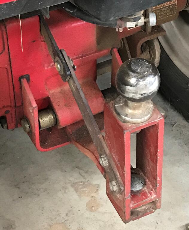

lynnmor 7,946 #11 Posted July 7, 2020 (edited) I had a ball mounted on the drawbar and bent it right down with a heavier than average popup camper. I made a ball mount that pins to the drawbar and also links to the upper transmission bolt. With this setup, I have the ball higher and as far forward as possible. The popup is long gone, but the hitch will handle a 6-1/2' x 12' trailer piled high with mulch. In the photo you will see that the support is in two pieces pinned together. I just drop a pin in the drawbar and pin the support. The upper part stays on the tractor. Edited July 7, 2020 by lynnmor 1 1 Share this post Link to post Share on other sites

David Ullman 142 #13 Posted July 7, 2020 The other thing I did was drilled and tapped the front of the draw bar, then used a bolt to take up the play. With a small plate between the draw bar and transmission to distribute the weight. 1 Share this post Link to post Share on other sites
