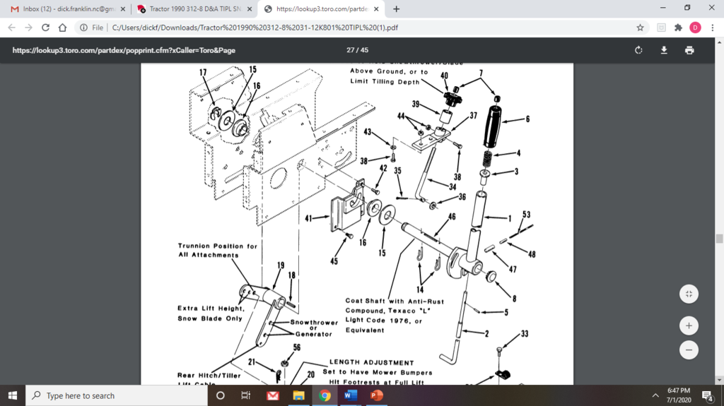

953 nut 63,389 #4 Posted July 1, 2020 The concept of changing over to a manual lift sounds rather straightforward, but in reality it would be a major PITA. In the drawing below you will see item # 46, Lift Lever Shaft and the associated parts. To change out the shaft all you would do is remove the two pins # 14 and slide the old shaft out and then insert the new one through the Bell Crank # 19. Unfortunately on the vast majority of the bell crank has rusted to the lift lever shaft and you will need to remove the entire dash tower assembly and use a 20 ton or larger hydraulic press to get the old shaft out. In my opinion you should stick with the electric lift. 2 Share this post Link to post Share on other sites

dalez 139 #7 Posted July 2, 2020 2 hours ago, 953 nut said: Unfortunately on the vast majority of the bell crank has rusted to the lift lever shaft and you will need to remove the entire dash tower assembly and use a 20 ton or larger hydraulic press to get the old shaft out. This has also been my experience too. 1 Share this post Link to post Share on other sites
