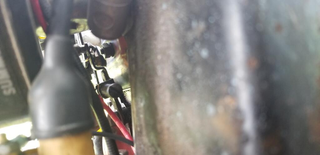

BrianX128 113 #4 Posted July 2, 2020 (edited) Not the best picture sorry hard to get in there. That's the second fuel filter I need to remove btw.. didn't have anymore hose in stock when plumbing my electric pump so double filtering it. I can say nothing is stopping the throttle from moving its just like it doesnt have enough travel or tension from the governor. Well it does to wide open, it doesn't lose enough for idle. Edited July 2, 2020 by BrianX128 Share this post Link to post Share on other sites

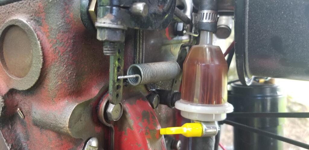

BrianX128 113 #5 Posted July 8, 2020 So I tried some more things and was able to get the rpm range from 2100 to 3400 now, but still can't get it below 2100. I moved the throttle cable from the big hole in the middle to the bottom hole so it has more travel. If I screw in the screw in the second picture I can get down to 1600 idle, but then I can only get up to 3000 rpm wide open. If I move the governor side of the spring down I can higher rpm but it still idles high, and the reverse happens if I move it up. Just can't get a long enough "travel" no matter where I put it. Share this post Link to post Share on other sites

BrianX128 113 #9 Posted July 15, 2020 Does yours have the "arm" that links to the throttle on the flywheel cover to pivot on? This is the only one I have that doesn't have that piece and has that strange little set screw you see in the second picture I posted. I'm wondering if this version just isn't compatible with that type of throttle. Come to think of it, I have no clue where this K301 really "lived" before I got it. Previous owner got it for a golf cart not realizing the shaft size was 1 1/8" not 1" and couldn't do what he wanted with it. It also had a gas tank mounted on top of it and 3 studs in the head instead of bolts for the tank to mount to, and the decal was on that plate like it was original. Not sure what that means it would have been on originally, but it couldn't have been on a horse, you could have never shut the hood? Share this post Link to post Share on other sites
Tuneup 1,452 #10 Posted July 21, 2020 Hi Brian - sorry so long to answer. Hopefully, you'll see this. My 125 has that same linkage. The throttle arm closes enough at low throttle to actually push the spring against the governor to force the throttle closed. The throttle cable on mine connects to the blower housing. The cable is connected at the top of the lever. Adjusting for low throttle - pushing the cable through the clamp until the governor spring forces the throttle fully closed. If you can't get to 3600 on high afterwards, adjust the throttle cable lever spring location to provide for more pull. Make sure first that the high thottle stop isn't cutting it short. Once to 3600, move that stop to end further travel. At least that is my adjustment method. Share this post Link to post Share on other sites
