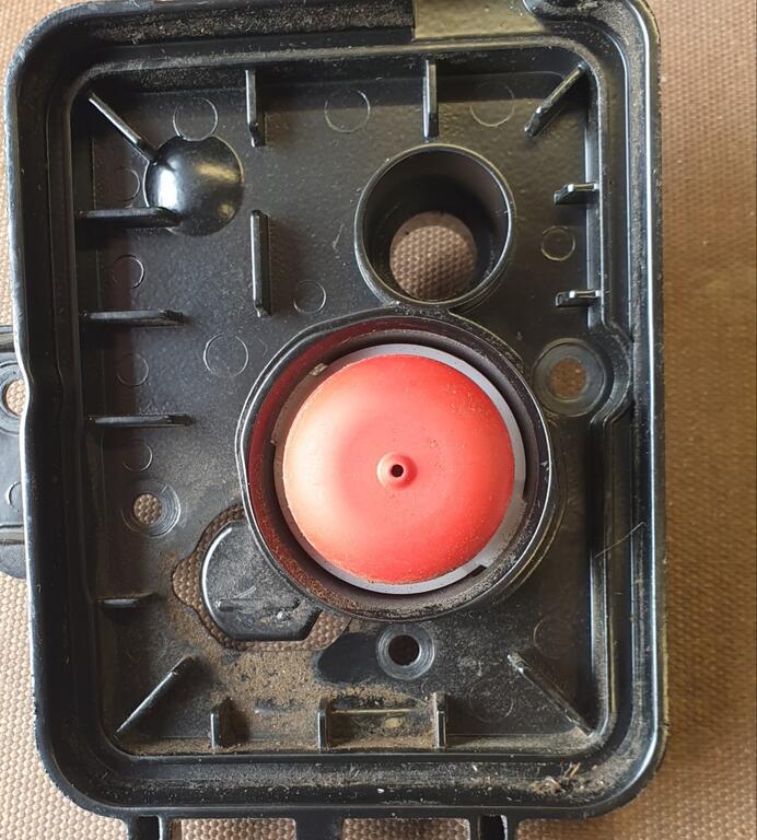

Mickwhitt 5,239 #1 Posted July 1, 2020 Hey all. My friend asked me to look at her mower as it was hard to start. I started it no problem so I suspect she is just a bit weak lol. The main problem is the air filter cover and element are missing. She says something black fell off and got chewed up a while ago! It's a fairly new mower but it's a DIY store own brand so parts are hard to source. It is a Briggs and stratton engine but I cant find the model on their website. I will have a hunt round for a cover but could conceivably make one. My worry is her running it without an air filter. How long would it take for serious damage to occur? The venturi was lined with a thin film of grass dust so it has been used without the cleaner for some little time. 1 Share this post Link to post Share on other sites

Mickwhitt 5,239 #6 Posted July 1, 2020 I've managed to navigate my way through the minefield of Briggs and stratton technical data and located a part number. But it's not shown as available. BUT they might still be able to get hold of one. I will see if one is available as it would be tricky to replicate. The air filter housing incorporates the fuel priming pump and crankcase breather. Share this post Link to post Share on other sites
Mickwhitt 5,239 #7 Posted July 3, 2020 Nice new air filter and cover obtained from my local mower fitted and all looks ok. I dont think there was too much crap sucked into the carb but time will tell. 2 Share this post Link to post Share on other sites
