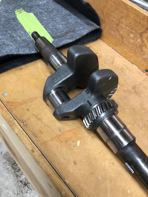

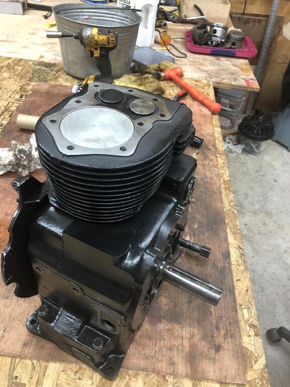

The Tuul Crib 7,340 #1 Posted June 26, 2020 So Irv is back in the shop for more repairs someone's knocking at the door or in this case the oil pan. Going back to the 14 horse that got gas in it the last time because of the fuel pump. Hope it's quick this is a great cutting tractor ! I took two cranks to my machine shop friend at the tune of a whopping 80 bucks! I'm taking a 16 horse block with me that has been bored 20 over and thinking about going to 30 with it. Any thoughts? 1 Share this post Link to post Share on other sites
ebinmaine 76,544 #2 Posted June 26, 2020 1 hour ago, The Tuul Crib said: 16 horse block with me that has been bored 20 over and thinking about going to 30 with it. Any thoughts It is usable at .020? Leave it alone if so. No real gain in an increase of .010. 2 Share this post Link to post Share on other sites
The Tuul Crib 7,340 #3 Posted June 26, 2020 2 hours ago, ebinmaine said: It is usable at .020? Leave it alone if so. No real gain in an increase of .010. Well the piston that was in it when the rod blew was 20 over. I'm not sure what the PO did to the motor but he was using it for pulling. Have been told you can go to 30 if you're not pulling maybe someone correct me if I'm wrong. He's going to check with the dial board gauge see what's going on with the cylinder and check the piston out as well. If they're fine I'll just do a hone job and new rings. 1 Share this post Link to post Share on other sites
The Tuul Crib 7,340 #4 Posted June 27, 2020 (edited) Yesterday got some things together. Picked up the two cranks from the machine shop. One for this one and one for my k341 build later. Hope to having this running this weekend. Edited June 27, 2020 by The Tuul Crib 2 Share this post Link to post Share on other sites

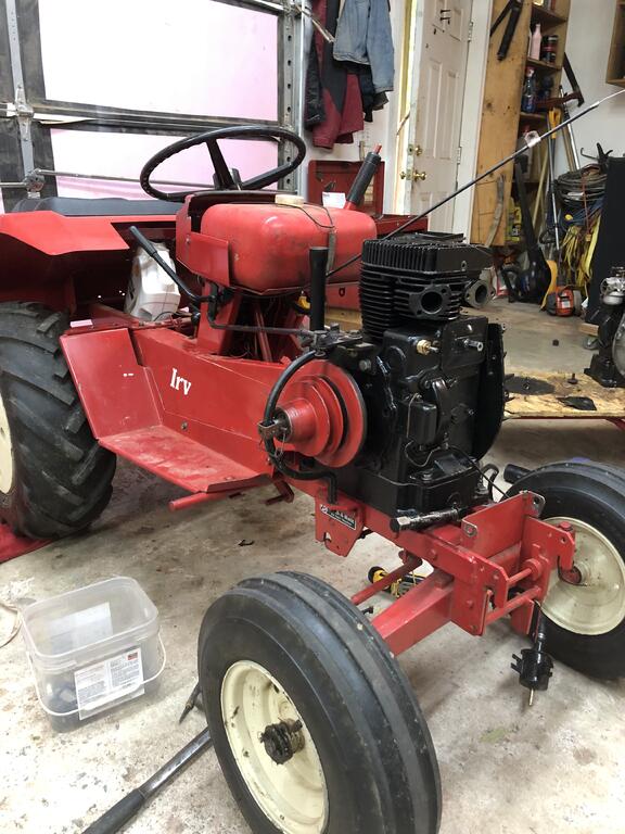

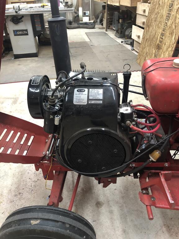

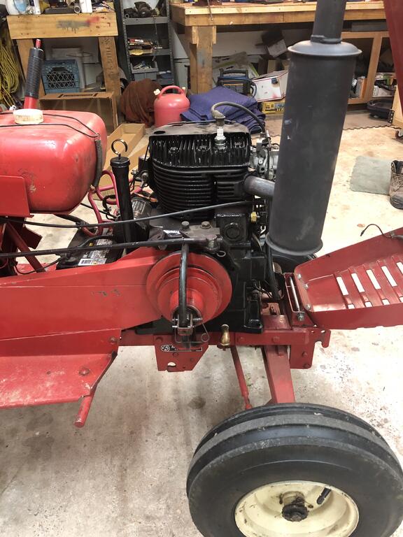

The Tuul Crib 7,340 #5 Posted June 27, 2020 (edited) The 14 is on! Edited June 27, 2020 by The Tuul Crib 1 Share this post Link to post Share on other sites
The Tuul Crib 7,340 #6 Posted June 27, 2020 Done !! Back and running ! Two cranks it popped right off!! Sounds like a Kohler!! IMG_8156.MOV 1 Share this post Link to post Share on other sites
