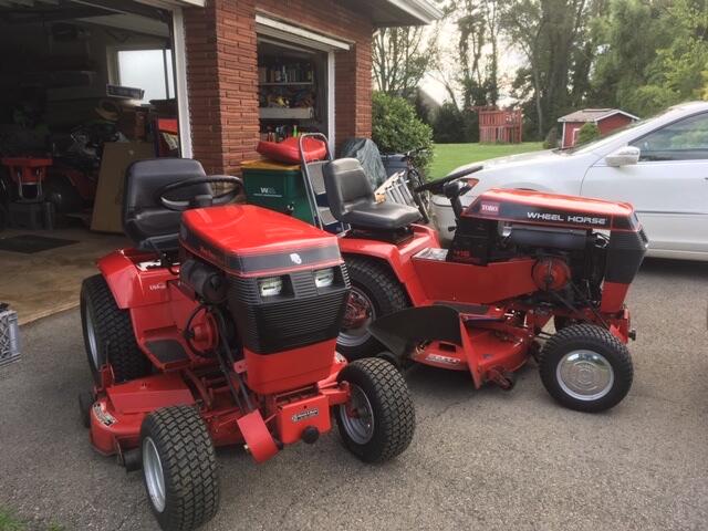

tom2p 2,396 #26 Posted June 26, 2020 (edited) pic of 312-8 with 8" front wheels (foreground) the appropriate/ shorter spindles can be installed - but not really required ... there is typically enough mower deck adjustment to deal with the 1/2" increase in front ride height (and some will state the extra ride height is appreciated) Edited June 26, 2020 by tom2p 1 2 Share this post Link to post Share on other sites

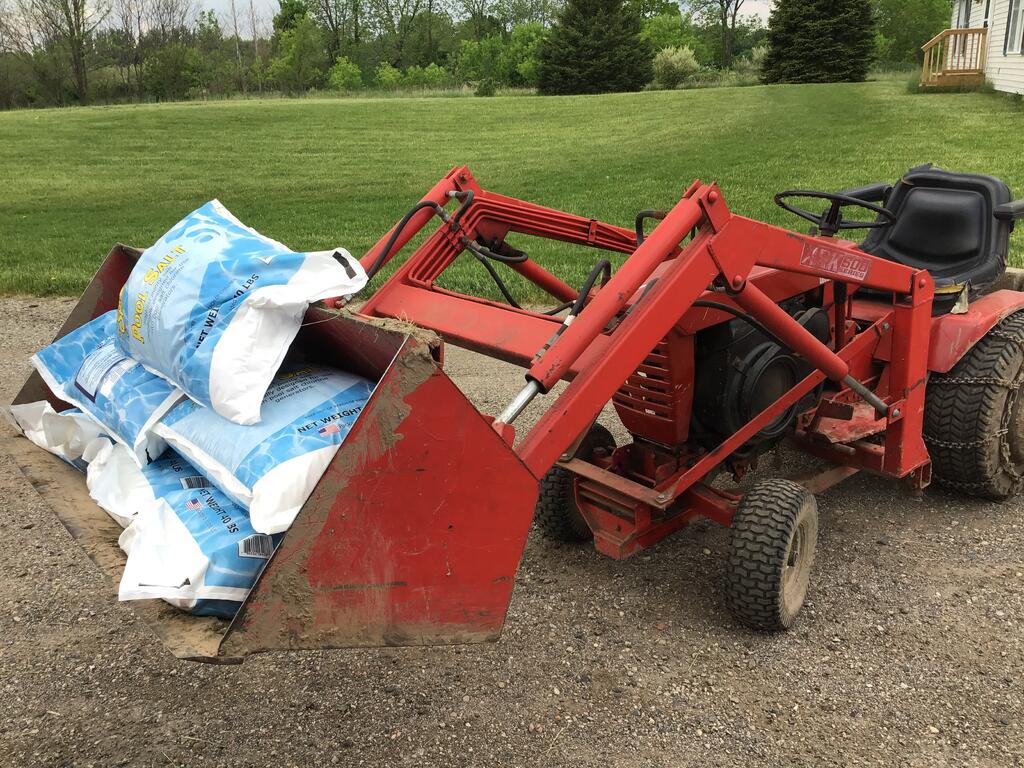

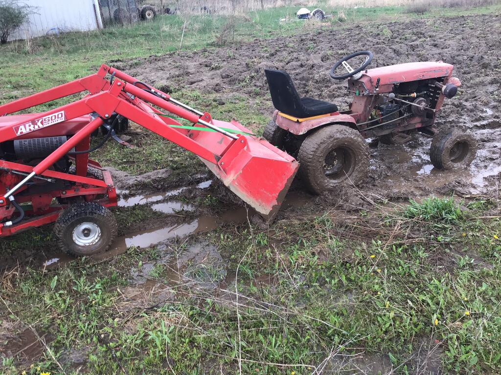

Pullstart 71,207 #27 Posted June 27, 2020 23 hours ago, ebinmaine said: I don't think I'd worry about running six inch wheels unless I was going to be doing something like a front end loader. 23 hours ago, Dan.gerous said: Just for the look 🙄 never been a fan of tiny wheels. late to the party... but my 1056 with 6” wheels at max psi do everything I ask of them 2 Share this post Link to post Share on other sites
