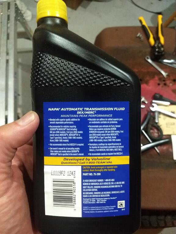

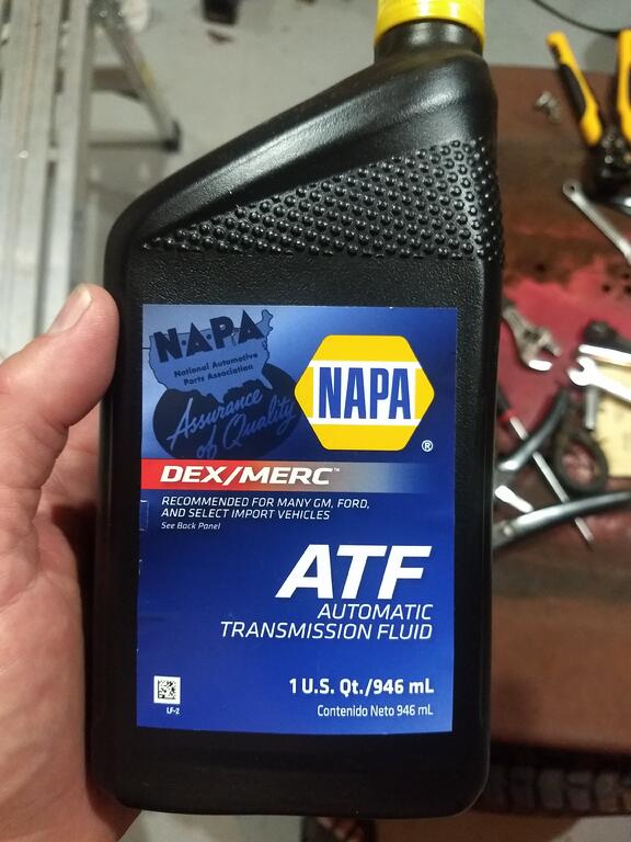

ebinmaine 76,652 #7 Posted June 22, 2020 Mike this is what I bought to use in the charger when I change the oil in that transmission 1 Share this post Link to post Share on other sites

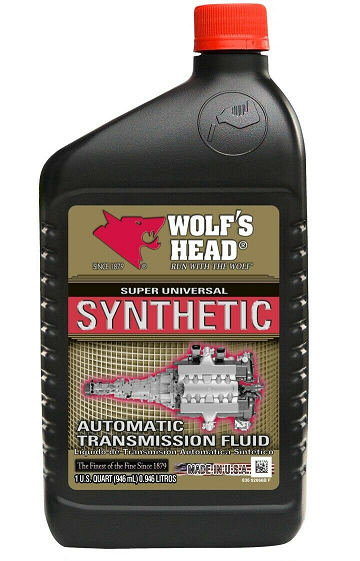

rmaynard 16,782 #9 Posted June 22, 2020 (edited) I replaced the fluid in my 875 last summer. Since Type-A was called for but was not to be found, Wolf's Head Super Universal fully synthetic transmission fluid was recommended as a suitable replacement. What I found is that; 1. It stinks like rotten fish. 2. It does NOT perform as good as the old red type-A I'm going to drain it again and refill with Wolf's Head hoping that I may not have gotten all the old stuff out, or that I may have some air in the system. Looking back, I wish I could find Type-A Edited June 22, 2020 by rmaynard Share this post Link to post Share on other sites

squonk 45,119 #12 Posted June 23, 2020 (edited) 3 hours ago, rmaynard said: Let us know how it works out. Funny you posted this Bob. Went to the Napa. They showed like 5 bottles on my computer but they only showed 1 on theirs. He says lets see if I can find it. He does find it and puts it on the counter. The bottle says Type F. Nothing about A nothing about GM specs NOTHING! It shows up on line as FA, My Napa Prolink shows it as FA but it's F . Now I'm thinking this bottle was probably on the shelf since I worked there 18 years ago. I googled just Napa type F and nothing shows up at all. So to be safe I used the generic non synthetic Napa 75-200 Dexron Mercon that Eric posted. Once Corona is finally over and I can prowl the store, I'm going to look for a new bottle and see if it's FA. Edited June 23, 2020 by squonk Share this post Link to post Share on other sites
