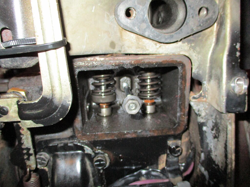

johnnymag3 2,646 #61 Posted June 26, 2020 Some pics for you to peruse.......As I suspected with this many hours Share this post Link to post Share on other sites

johnnymag3 2,646 #73 Posted June 26, 2020 23 hours ago, Bill D said: Any luck? This engine has like no hours....................The stem was spotless...both the valves Share this post Link to post Share on other sites

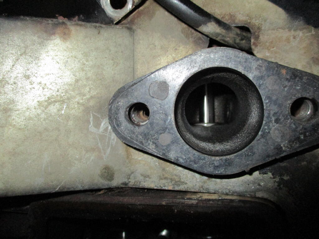

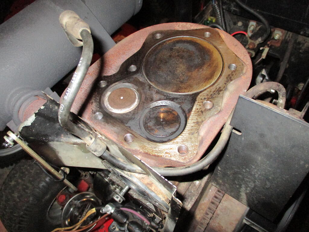

johnnymag3 2,646 #74 Posted June 26, 2020 the other pictures of the angry machine Share this post Link to post Share on other sites
