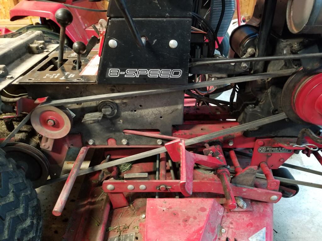

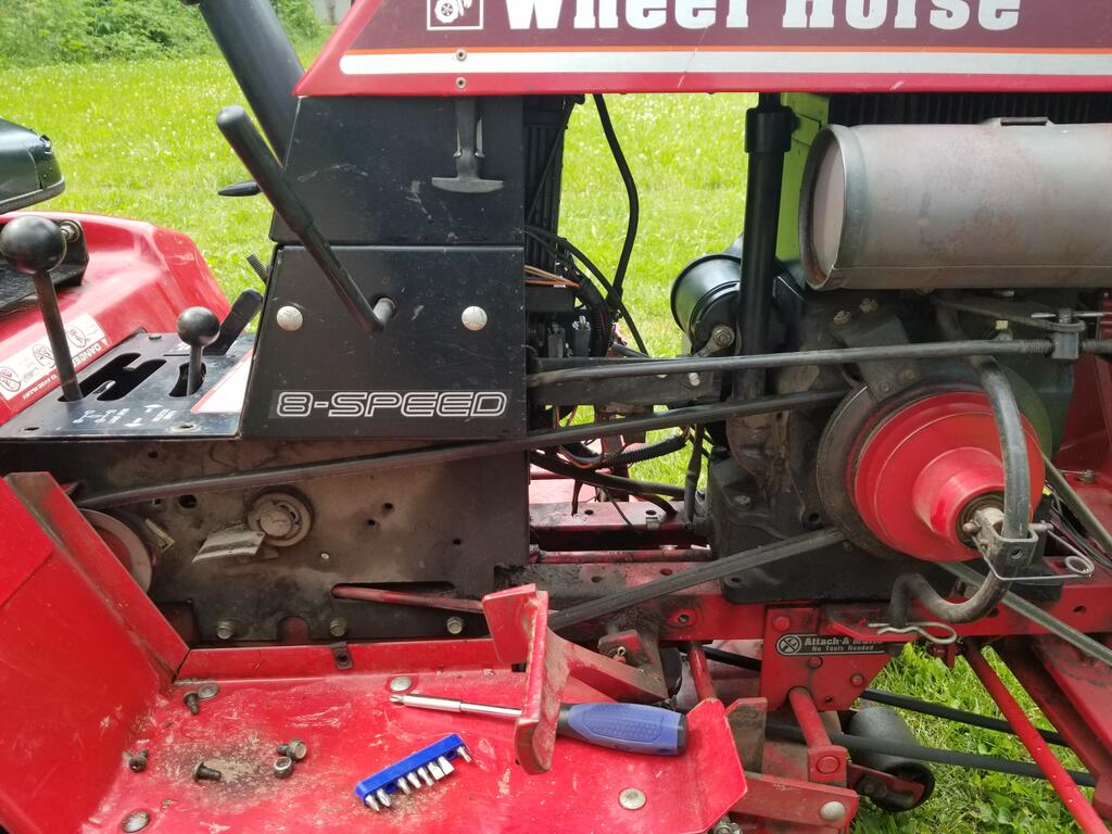

wallfish 20,733 #52 Posted June 22, 2020 It's clear from the pics that belt is too loose. It's slipping around the engine pulley when descending the hill and basically free wheeling. The brake doesn't work if it only slows it down on flat ground and not on the hill. Fixing the belt and brake will stop the free wheeling. 3 1 1 Share this post Link to post Share on other sites
oldlineman 1,820 #53 Posted June 22, 2020 Yes what everyone has stated, belt is too loose you can see that clearly in picture # 39. I have a 1989 414-8 which is heaver than your tractor and a 1979 c101-8 and have steep inclines in my yard and have no issues with run a away going down them. That 312-8 is twice the tractor what your other lawn mower is. Get a new wheelhorse belt and check tension er you won't be disappointed. JMHO I have owned and used these tractors for over 40 years with no issues. Bob 1 Share this post Link to post Share on other sites

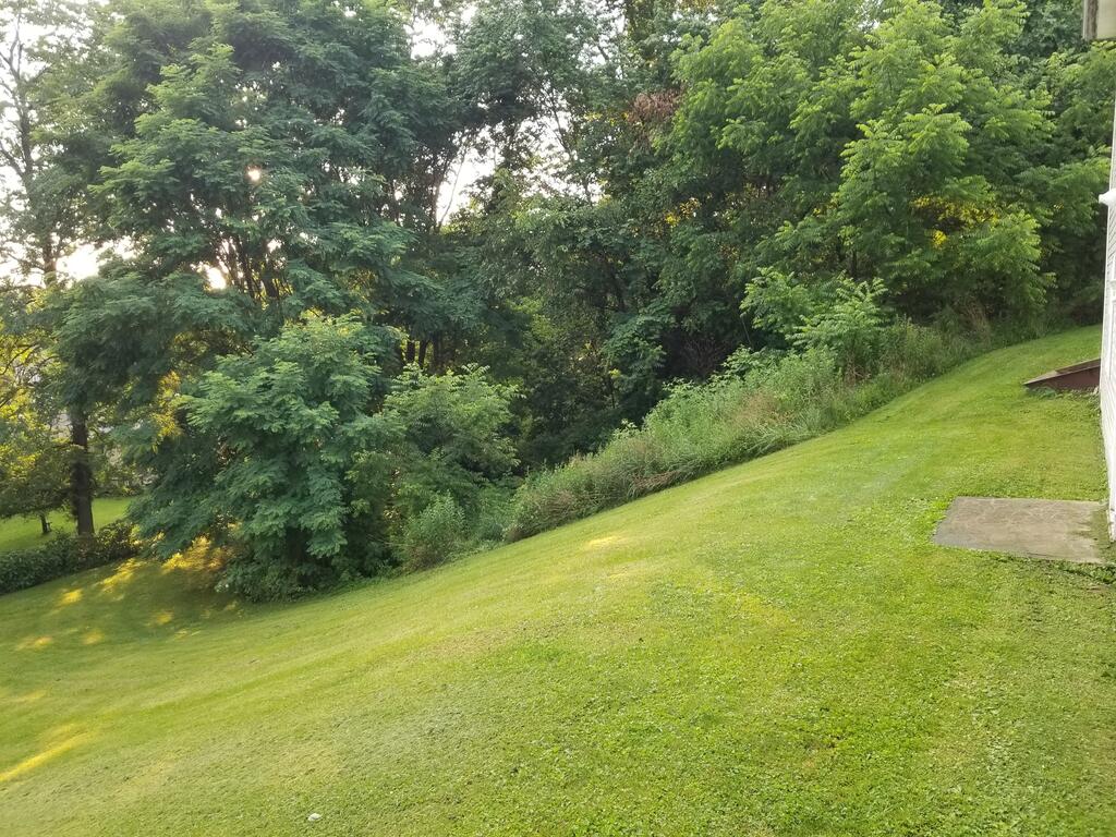

wallfish 20,733 #59 Posted June 23, 2020 2 hours ago, Jhatch13 said: i have had mechanics tell me I can easily fix it myself along with how to do it. From thier perspective, being honest and saving someone a few bucks will earn thier business in the future. Exactly! The lining Bob sells will grip that drum good so you should be all set after the brake and belt repairs. Please update us and maybe a pic of the hill too. Share this post Link to post Share on other sites
Jhatch13 31 #60 Posted June 23, 2020 Ive tried to take pictures of the hill, but none of them turn out good enough to show the steepness of the grade. The worst part is after about 40 feet of flat at the bottom, there is a small drainage ditch, and everything is surrounded by briar patches, so if I go for another wild ride it could turn out worse. If i'm lucky and athletic enough to jump off (which Im not) the tractor could possibly roll into the neighbors house. Ive never felt like the 211 was struggling or out of control unless I hit a wet patch and would get a little sliding. I thought the extra power, weight, and wheelbase of the 312 would help keep it planted, but the center of gravity is definitely higher and probably why it feels so squirley in comparison. Maybe I can get video of the next try after everything is back together. If it doesn't work then at least it will be cheap entertainment. Share this post Link to post Share on other sites
Jhatch13 31 #61 Posted June 27, 2020 I replaced the clutch spring and the drive belt this evening. It was definitely shorter than the aftermarket one that was on it. (Original on top, new on bottom). After inspecting the brakes, it looked like the original liner was in good shape, so I decided to hold off on replacement and just made some adjustments and it locks up the rear wheels solidly now. We had a big thunderstorm going on as I was working so I did not get to try it on the hill. Hopefully it will dry out tomorrow and Ill get to report back a successful descent and climb. 2 1 Share this post Link to post Share on other sites
Jhatch13 31 #62 Posted June 27, 2020 Tried the hill about 5 minutes ago in low 1 and again in low 2, same result.........rolls right down the hill, but climbs like it isnt even a challenge. Guess ill be sticking with the 211 for now and looking for another vertical shaft. 1 Share this post Link to post Share on other sites
kasey54 305 #63 Posted June 27, 2020 Did your repairs make the belt tighter? It needs to be tight with your foot off the clutch pedal. I can tell you are very frustrated. If you have some one to help you , you could push the 312 on flat ground, or tow it with your lawn mower. In 3rd gear as its rolling forward you should be able to determine what is slipping. If your engine doesn't turn ,and it rolls easily something is slipping. This is a fact. You could have a bad key in your hubs,(rear wheels will turn on the axle shaft . check both of them) You could have a bad key on your input transmission shaft(pulley will turn but shaft don't). If your idler pulley is bad the belt will slip over the engine pulley. There is a pinned arm that moves the idler pulley tighter clutch out, loosens it clutch in. If that movement is absent, or not enough it won't tighten your belt. When you let up on the clutch the spring is supposed to pull the idler pulley tight.(even in neutral). Any of these keyed shafts can wear and in effect make a ratchet like situation. They will grab in one direction, but in this case if the tractors momentum is pushing it faster than the gears are going they may be slipping, and not holding it back. To see if the transmission shaft is slipping in its pulley you need to remove the belt guard to see. If you see this through you will find the 312-8 is twice the machine (a garden tractor) that your 211 is.(a lawn mower) Good luck, please keep us posted. 1 Share this post Link to post Share on other sites

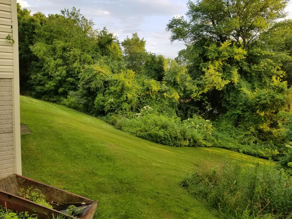

Jhatch13 31 #72 Posted June 29, 2020 I tried to get some pictures of the hill. Its steeper than it looks. Im guessing 40-50 feet from top to bottom, with about a 20 degree grade. Share this post Link to post Share on other sites

lynnmor 9,073 #74 Posted July 2, 2020 1 hour ago, Jhatch13 said: I had my wife video me going down the hill. It does look like one tire is spinning the opposite direction of the other. This happens shortly after it starts to accelerate forward down the hill. Now it appears that wheel weights and better tires are needed. 1 Share this post Link to post Share on other sites
echris 1,426 #75 Posted July 2, 2020 I know it's hard to judge a grade from a photo, but that looks similar to one of the hills in my yard and my 310-8 goes down it just fine, even with a slippery carpet of white pine needles on the hill. Have you looked at the wheel hubs? It sounds backwards, if it holds torque up the hill it should hold going down, but it's harder to walk down a hill than up. Maybe a slight slippage? The one tire spinning the opposite direction comment made me think of that. Dunno of that makes sense though. Share this post Link to post Share on other sites
