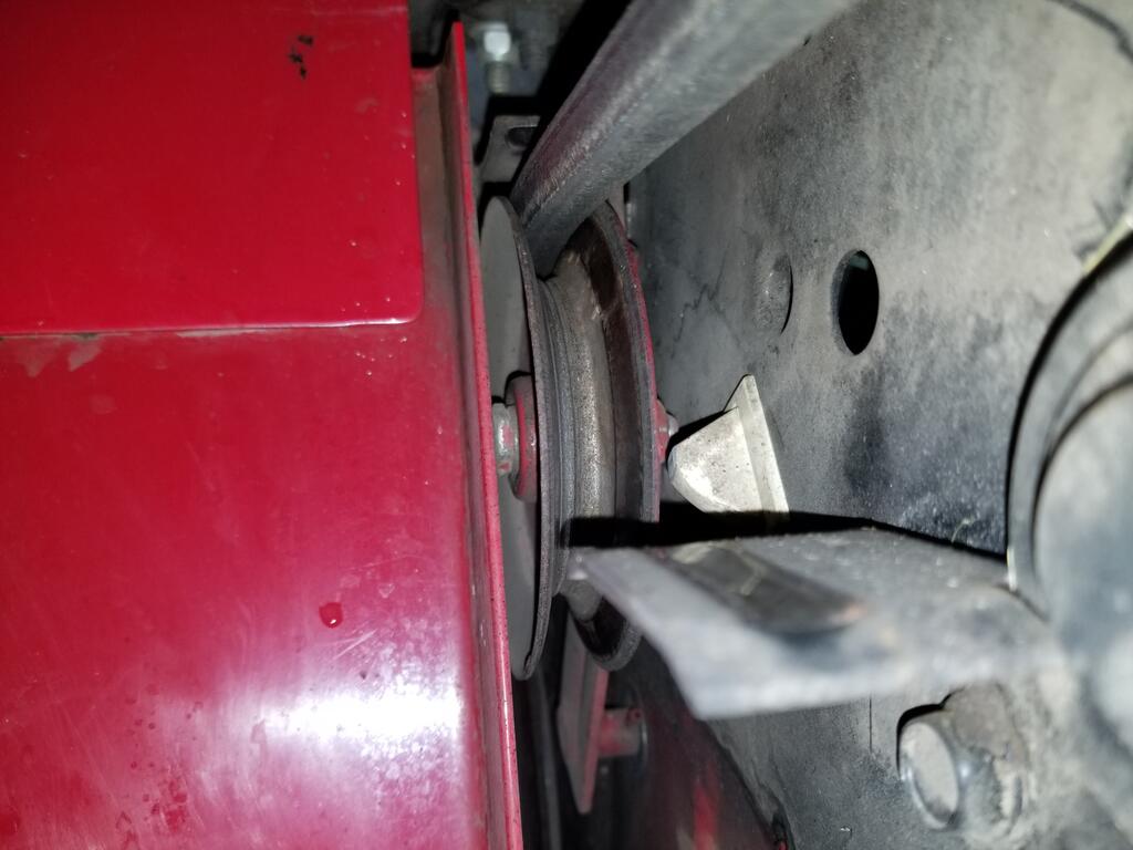

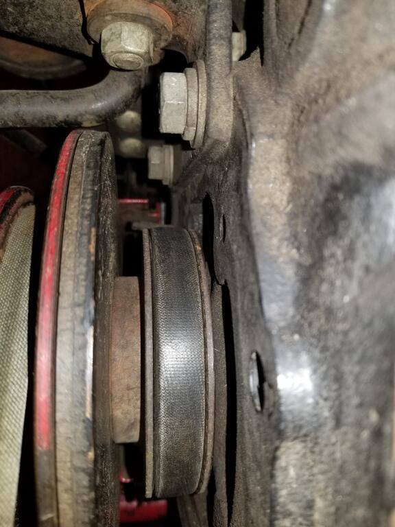

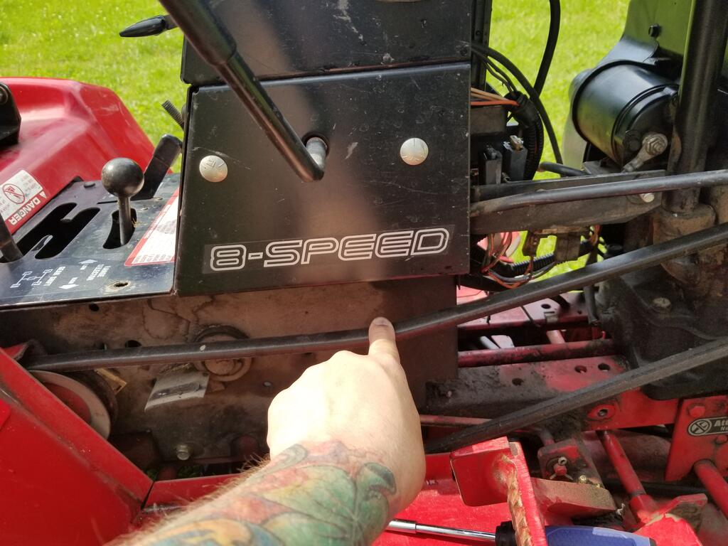

Jhatch13 31 #29 Posted June 21, 2020 44 minutes ago, squonk said: As belts wear they get thinner. This is what everybody thinks is "the belt stretched" Belts do not stretch. When the sides wear in too far they don't grip the sheaves so the only gripping point is the inside of the belt which is not designed to grip. When you get the guard off, lets see a pic of the belt. Heres a few Share this post Link to post Share on other sites
Tractorhead 9,218 #30 Posted June 21, 2020 If the lower Pict is with engaged clutch, than the Belt is definitiv too loose. I see a wear on belt undersite, but on that picts i cannot exactly see how the belt fit‘s into the Pulley as @squonk mentioned. when the belt touches the Pulley bottom on the lower side, than it‘s a to worn belt or even a wrong sized Belt try a pic along the belt facing to the Pulley, to see how it fits. but as far as i can see on that Picts it seems it‘s to worn. what i see so far is firstly a to loose Belt, that causes in a lost friction, what explains also your traction loss. The to loosen belt can be also seen on the upper Pict, short after the Pulley. there is a lightly wave, what shouldn‘t be. Share this post Link to post Share on other sites
Jhatch13 31 #31 Posted June 21, 2020 1 minute ago, Tractorhead said: If the lower Pict is with engaged clutch, than the Belt is definitiv too loose. I see a wear on belt undersite, but on that picts i cannot exactly see how the belt fit‘s into the Pulley as @squonk mentioned. when the belt touches the Pulley bottom on the lower side, than it‘s a to worn belt or even a wrong sized Belt try a pic along the belt facing to the Pulley, to see how it fits. but as far as i can see on that Picts it seems it‘s to worn. what i see so far is firstly a to loose Belt, that causes in a lost friction, what explains also your traction loss. The to loosen belt can be also seen on the upper Pict, short after the Pulley. there is a lightly wave, what shouldn‘t be. Both pictures were with the clutch pedal not being depressed. Share this post Link to post Share on other sites
Tractorhead 9,218 #32 Posted June 21, 2020 Ok, than you found your problem. next thing is solve it. look along the Belt, if it touches the pulley inside with Belt bottom, it‘s to worn or wrong belt size Share this post Link to post Share on other sites

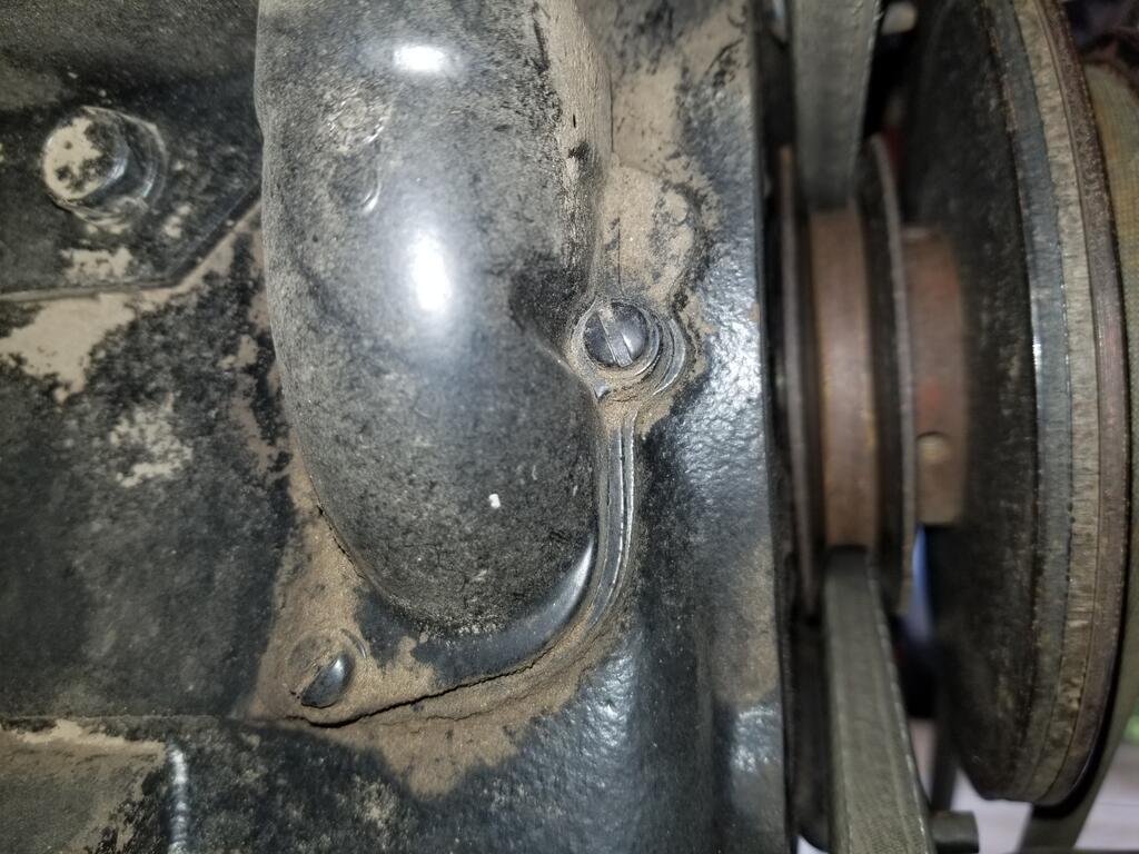

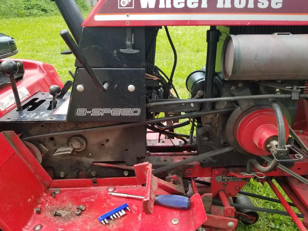

Jhatch13 31 #33 Posted June 21, 2020 It started storming here so I had to put it back together and bring it inside ( limited space to work it the garage). This is from the front side of the pulley (towards the grille pointing camera towards the rear end). The clutch was not depressed in this picture either. Share this post Link to post Share on other sites
Tractorhead 9,218 #34 Posted June 21, 2020 No, i meant from the other side, where the belt is running into pulley. Share this post Link to post Share on other sites
Jhatch13 31 #35 Posted June 21, 2020 Just now, Tractorhead said: No, i meant from the other side, where the belt is running into pulley. I will have to take the belt guard off later and get another picture. Thanks for the diagnosis! Share this post Link to post Share on other sites

squonk 48,339 #38 Posted June 21, 2020 23 minutes ago, Jhatch13 said: It started storming here so I had to put it back together and bring it inside ( limited space to work it the garage). This is from the front side of the pulley (towards the grille pointing camera towards the rear end). The clutch was not depressed in this picture either. That belt is sitting too low in the pulley. Replace it Share this post Link to post Share on other sites
Jhatch13 31 #39 Posted June 21, 2020 47 minutes ago, Tractorhead said: No, i meant from the other side, where the belt is running into pulley. Here is the front and rear pulley. Excuse my lack of photography skills. The belt measures 3/8 on the bottom of the "V" and 1 inch on the top. I believe 5/8 is what it should be. Share this post Link to post Share on other sites
