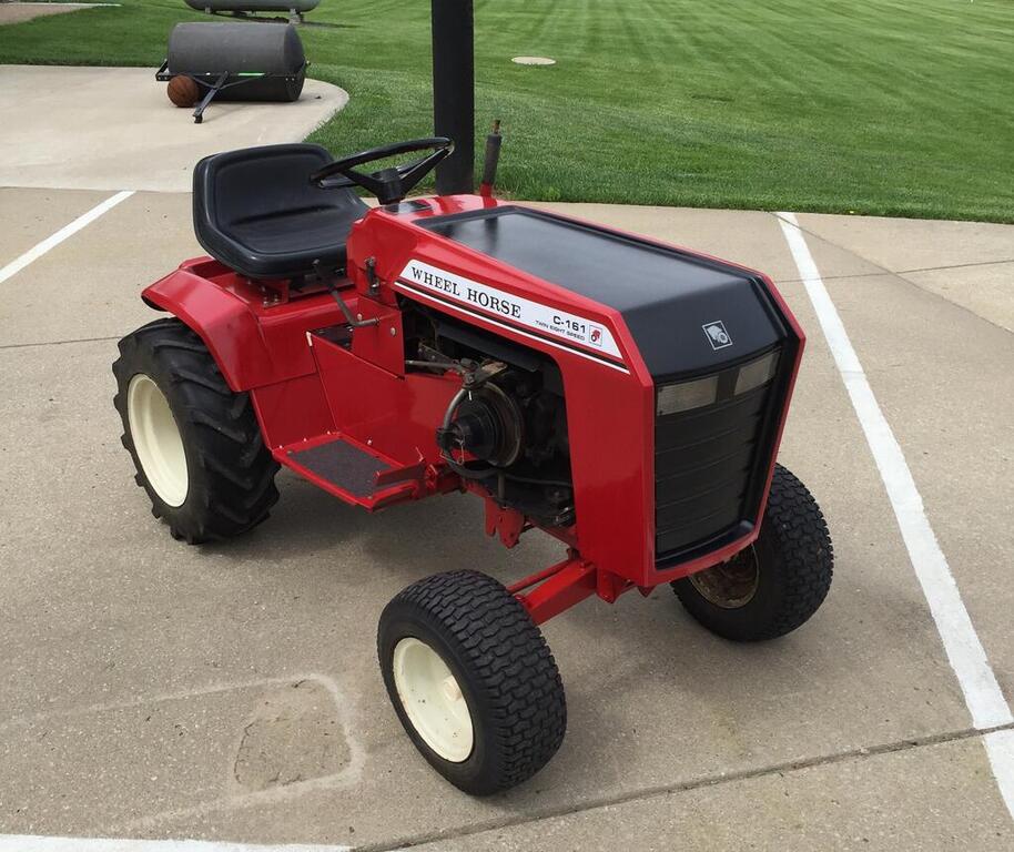

cschannuth 3,819 #3 Posted June 18, 2020 They were also available in 1978. This is my dad’s. I have it now. The story goes that because of the Kohler twin reliability issues Wheel Horse decided to use the Briggs twin instead and had to modify the hood to make it fit. My dad installed the metal seat pan a year after he bought it when the original broke. This has been a great tractor and has nothing done to it but fluid changes and some tires. I painted the wheels when I got it and dad would always rattle can the tractor here and there any time it got a scratch on it. It looks good from about 20 feet but you can tell when you get closer. 2 2 Share this post Link to post Share on other sites

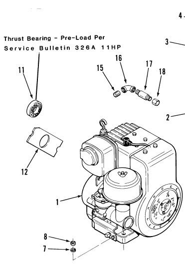

gwest_ca-(File Mod) 11,998 #5 Posted June 18, 2020 The B&S engines will not take the pressure the manual pto exerts on the crankshaft. Must use an electric pto or add a thrust bearing behind the engine pulley. Here is a picture of it Garry 1 Share this post Link to post Share on other sites
scWHhauler 96 #6 Posted June 18, 2020 The I/c engine has that bearing all ready in it. Man that is a great looking tractor cschannuth i think I will go and get my trailer to day I will get some picks. Share this post Link to post Share on other sites
