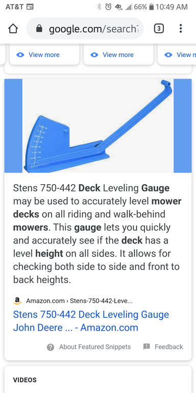

WVHillbilly520H 10,378 #4 Posted June 18, 2020 On RD decks the front should be 1/8" lower than the rear when measured by the center blade for best cut. Find you one of these gauges... Share this post Link to post Share on other sites

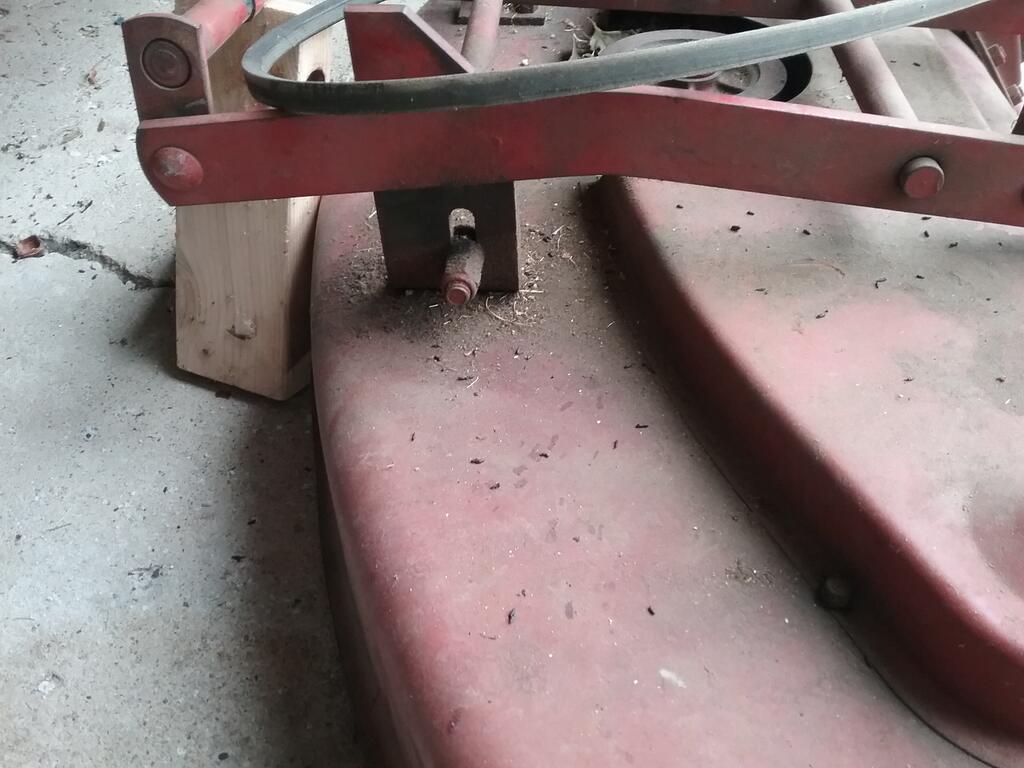

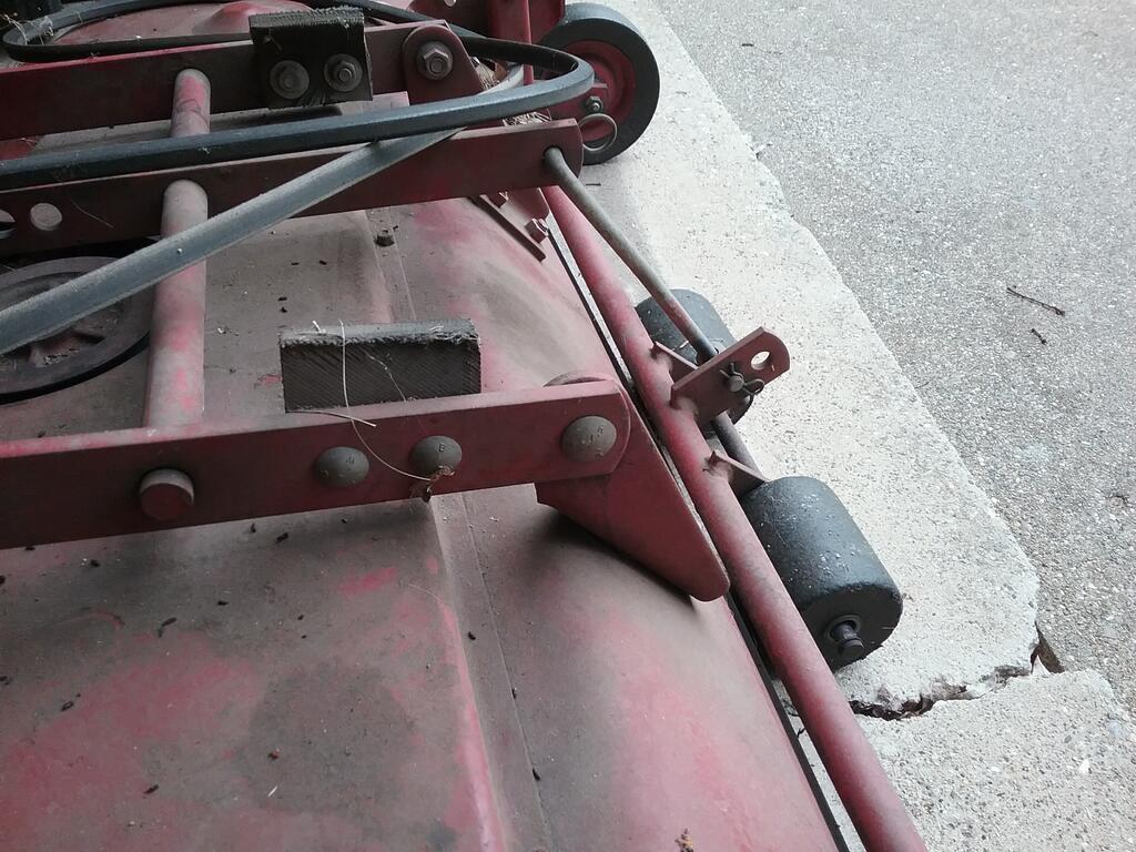

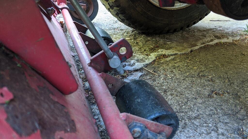

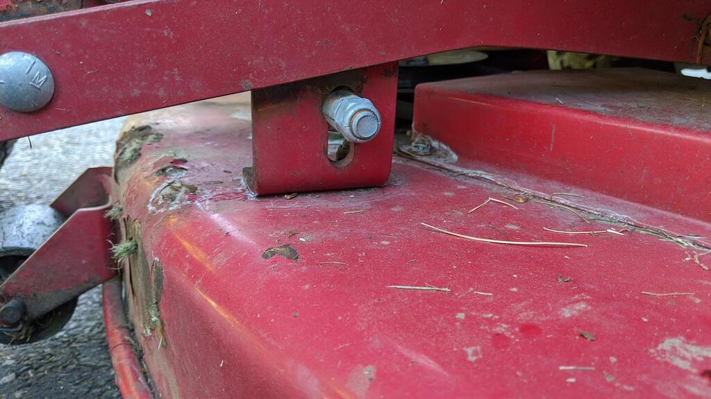

8ntruck 8,624 #5 Posted June 22, 2020 Sorry about the delay, but I finally got pictures of my 42" SD deck. This one is a '73 or '74 model, but I think the setup should still be the same. The deck stops on it are at the bottom of the slot, and the leveling rod is in the hole closest to the shaft. I was having difficulty getting my deck to latch in the up position. I found that the trunion that connects the deck lift linkage to the rock shaft was not sliding on the deck lift rod. This was caused by excess slop between the hole in the rock shaft and the trunion. A washer and new hitch pin in the trunion cleaned that up. Good luck. Share this post Link to post Share on other sites

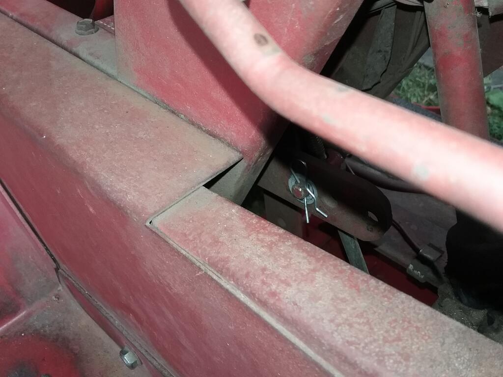

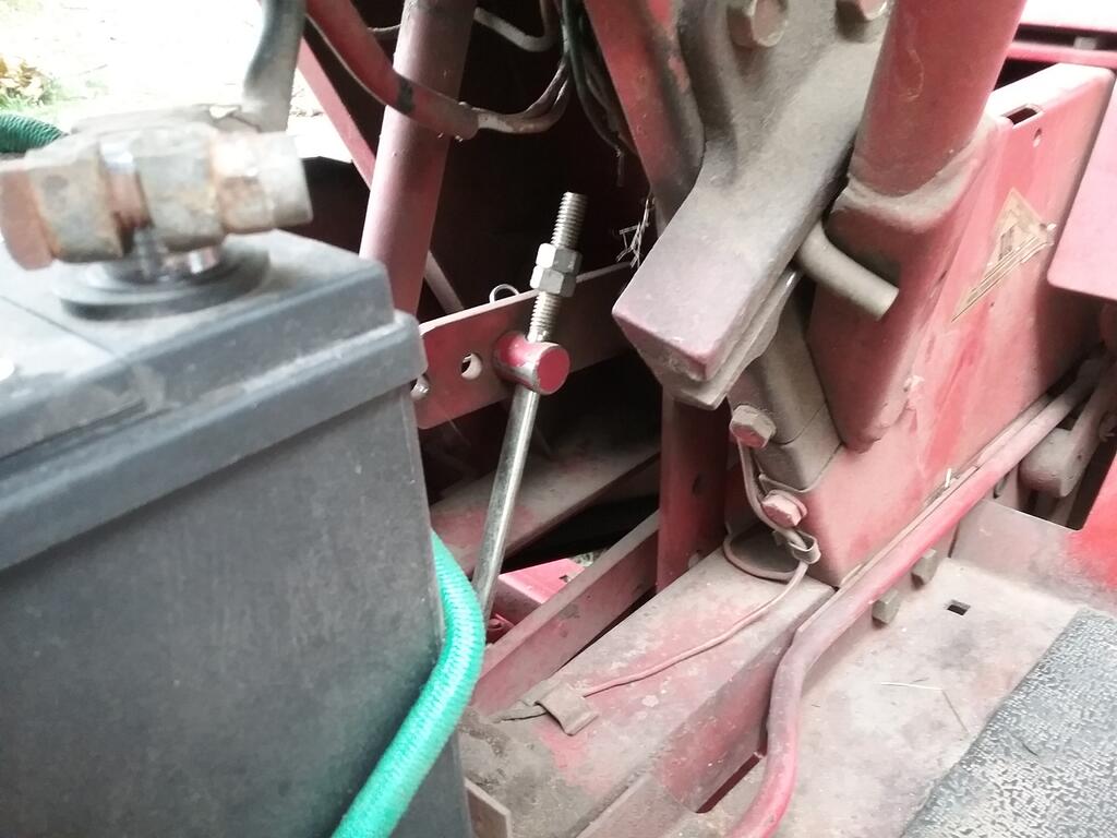

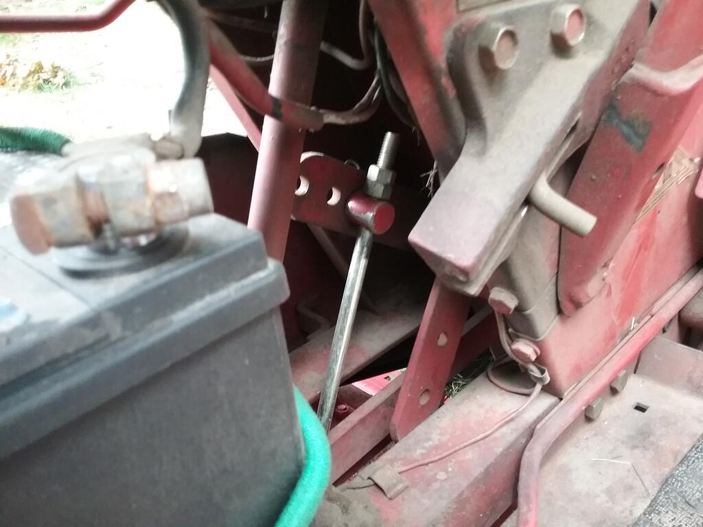

8ntruck 8,624 #8 Posted June 23, 2020 (edited) @tunahead72 - Here are the pictures: This is with the deck lifted, lift lever locked. Notice that the lift trunion is contacting the lift height adjusting nuts on the silver lift rod behind the battery. This is with the deck lowered into working position. Notice that the lift trunion is well below the adjusting nuts on the silver deck lift rod. In order for the lift lever to work, the lift trunion needs to slide easily on the silver deck lift rod. If the trunion is a loose fit in the lift lever on the rock shaft, it will tilt and jam on the deck lift rod before it gets all the way up to the adjusting nuts on the deck lift rod. This causes the deck to hit the up bumpers on the frame before the lift lever can lock in the up position. I was able to tighten mine up by adding a flat washer under the hairpin type hitch pin that holds the trunion on the lift lever. Hope this helps. Edited June 23, 2020 by 8ntruck 1 Share this post Link to post Share on other sites
tunahead72 2,621 #9 Posted June 24, 2020 Yes it does. That makes a whole lot of sense, and gives me a good place to start looking. The deck and tractor that are giving me this problem are both 33 years old, and all the lift mechanism parts are original. I won't be at all surprised to see worn holes and trunnions and pins when I start looking at it more closely. Thank you! Share this post Link to post Share on other sites
