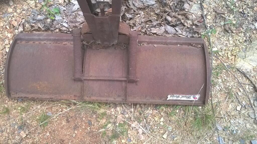

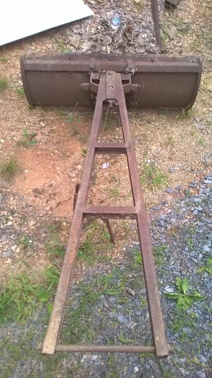

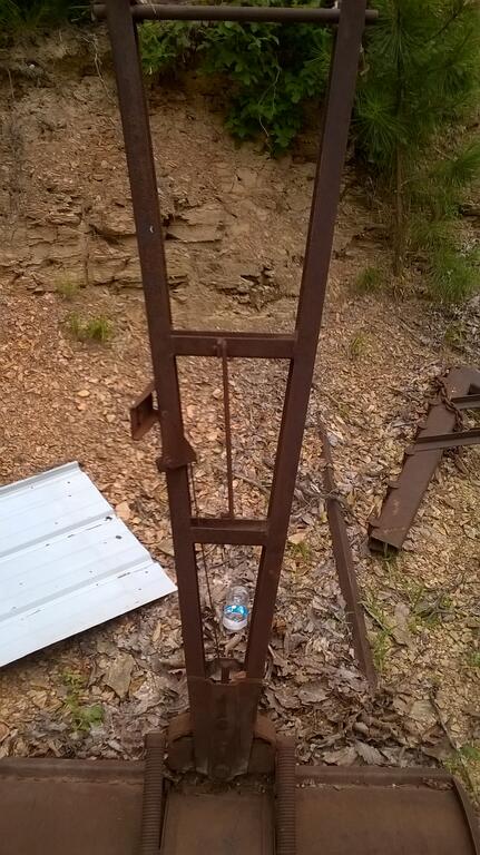

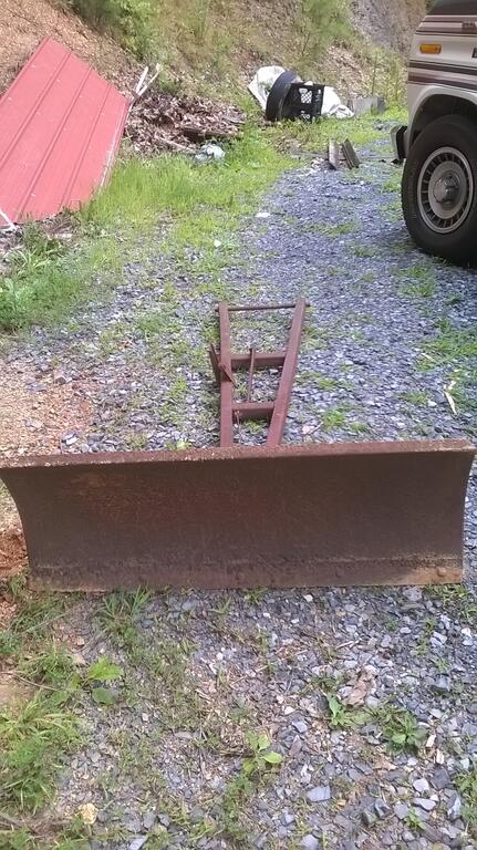

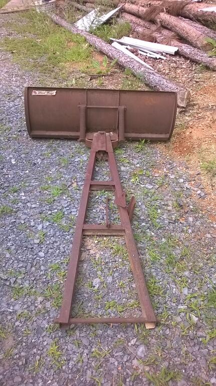

Charrie 18 #1 Posted June 17, 2020 We have a front blade for a wheel horse but not sure what model it fits. Maybe someone here will know. I don't think it fits on our 520H Thanks Charrie 1 Share this post Link to post Share on other sites
953 nut 64,328 #2 Posted June 17, 2020 The blade is for a "Short Frame" which would have been manufactured prior to 1968. 1 Share this post Link to post Share on other sites
gwest_ca-(File Mod) 12,015 #3 Posted June 17, 2020 Here is a list of the candidates Dozer DNA of short tractor frame dozer blades 1961 model BD-4271 - Fits SHORT frame tractors - Mounts ahead of the rear axle - replaced by 1962 model BD-4262 - Fits SHORT frame tractors - Mounts ahead of the rear axle 1963 model BD-4263 - Fits SHORT frame tractors - Mounts ahead of the rear axle 1964 model BD-4264 - Fits SHORT frame tractors - Mounts ahead of the rear axle 1965-1966 model BD-4264A - Fits SHORT frame tractors - Mounts ahead of the rear axle 1967 model BD-4267 - Fits SHORT frame tractors - Mounts ahead of the rear axle 1968 model 6-2111 - Fits SHORT frame tractors - Mounts ahead of the rear axle Garry 1 Share this post Link to post Share on other sites
WHX?? 55,237 #4 Posted June 18, 2020 Yes that is for a short frame and will not fit a 520 unless some real creative welding takes place. May I boldly suggest you acquire a short frame? 1 2 1 Share this post Link to post Share on other sites
