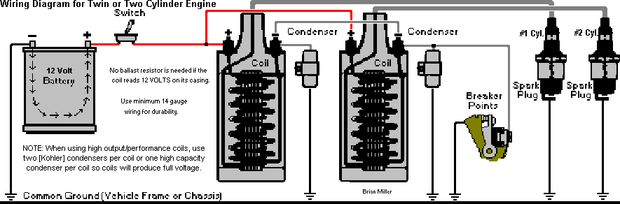

bc.gold 3,406 #4 Posted June 17, 2020 Those twin tower coils look nice and keep it tidy, but since both cylinders are firing at the same time, one on power stroke the other on exhaust so the spark does nothing. You could pigtail a single tower coil and have both hot wires connected to spark plugs or you could use two coils as shown below, the animation shows spark occurs at both plugs at the same time. Some starter solenoids have an "S" terminal used to supply a full 12 volts to the coil during start, for this configuration a non resistor coil is preferred with a ballast resistor place inline to reduce the voltage to the coil once the engine is running. Most modern coils today have an internal ballast. Share this post Link to post Share on other sites
