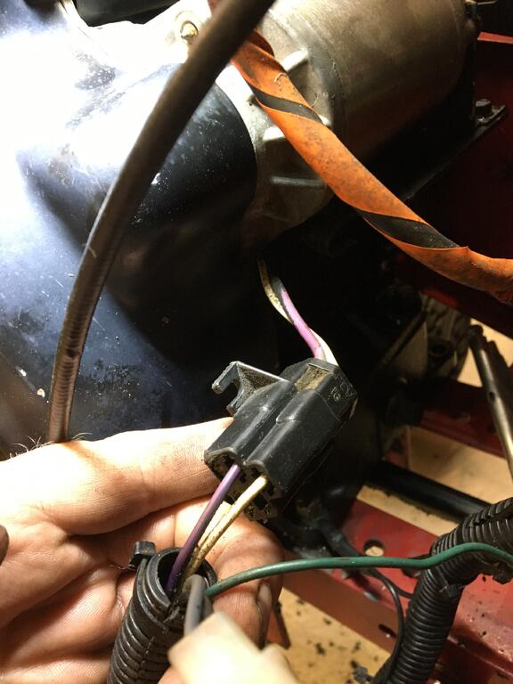

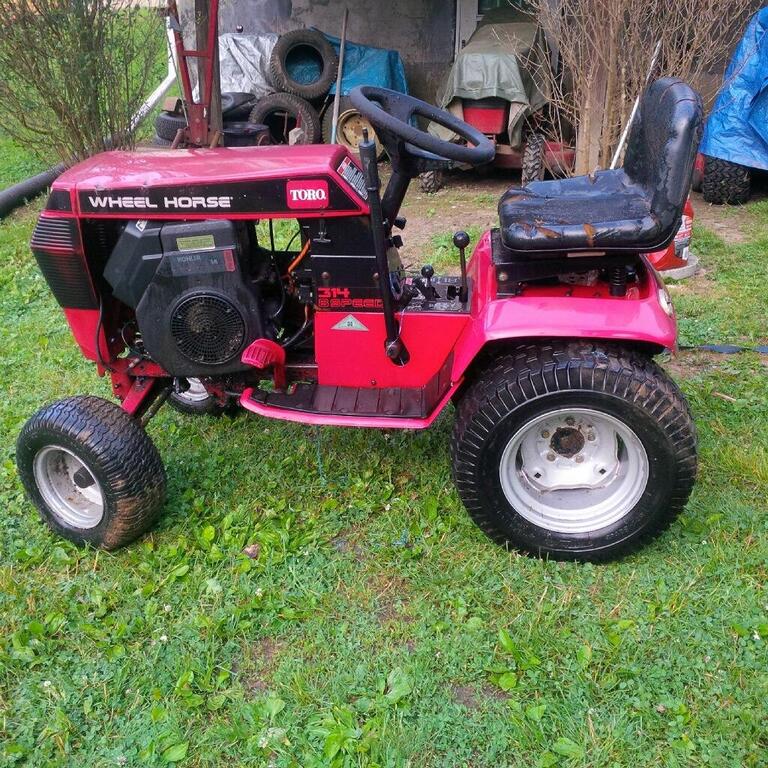

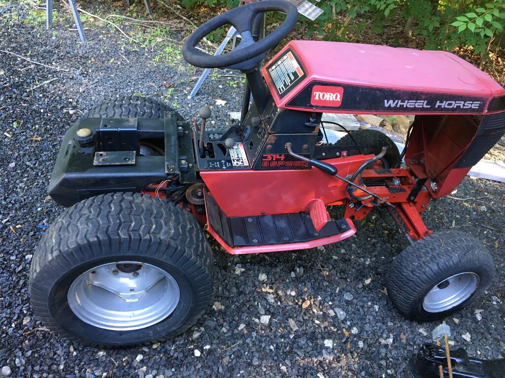

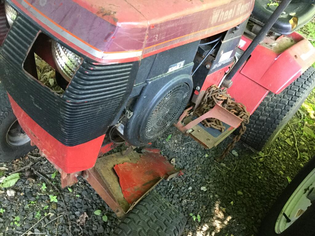

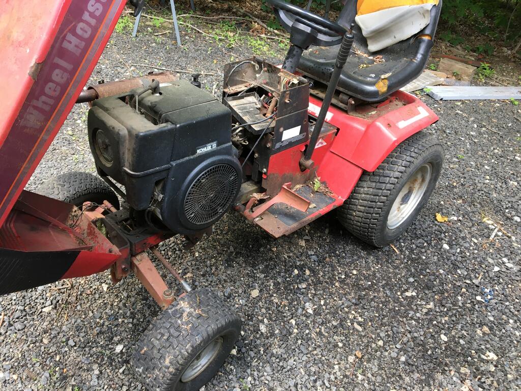

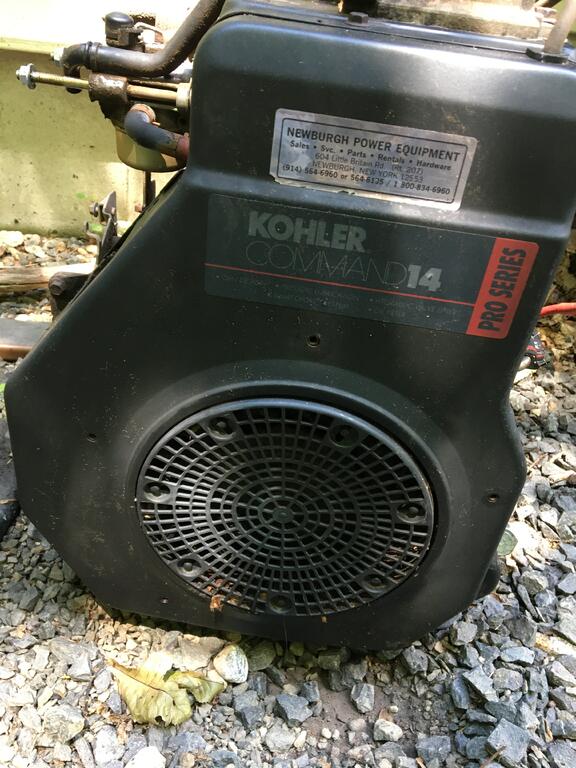

Sparky-(Admin) 24,627 #1 Posted June 14, 2020 I have a good Magnum 12 sitting on a really messed up 312/8. Been wanting to drop it in something. Picked up this 1998 314/8 with the OHVKohler 14, not sure about the status on the motor but I think it might be junk, oil everywhere and it was already unbolted from the frame. Pretty sure the Mag 12 is gonna have a new home soon! I know going from a K series to a Magnum the ignition wiring needs to be changed....what about from one of these new fangled Kohlers to a Mag? Both have electronic ignition. 2 Share this post Link to post Share on other sites

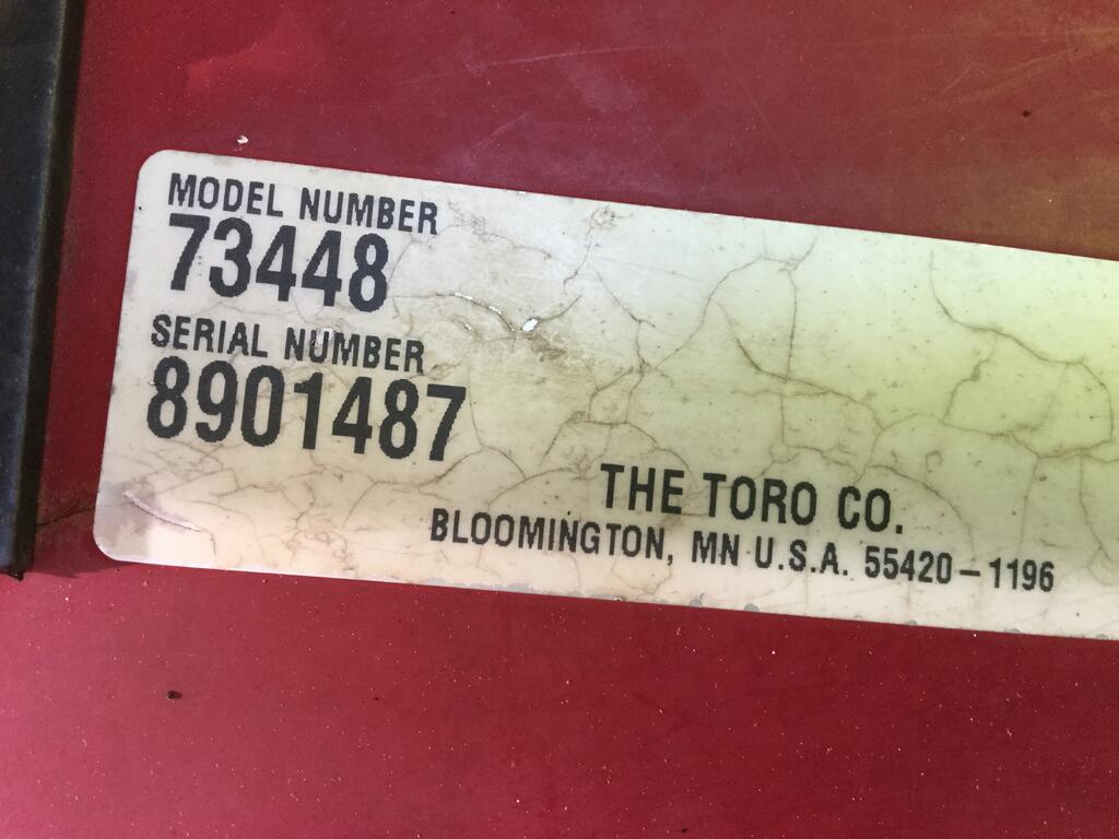

Sparky-(Admin) 24,627 #3 Posted June 14, 2020 20 minutes ago, gwest_ca said: Have the model number of the 312-8? Should be plug and play except possibly the charging system. Garry No info or tags on the 312....would the info off the Mag 12 help? It might still have its info decal Share this post Link to post Share on other sites

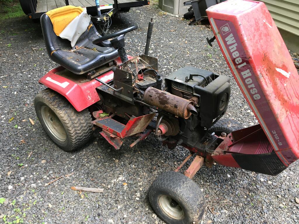

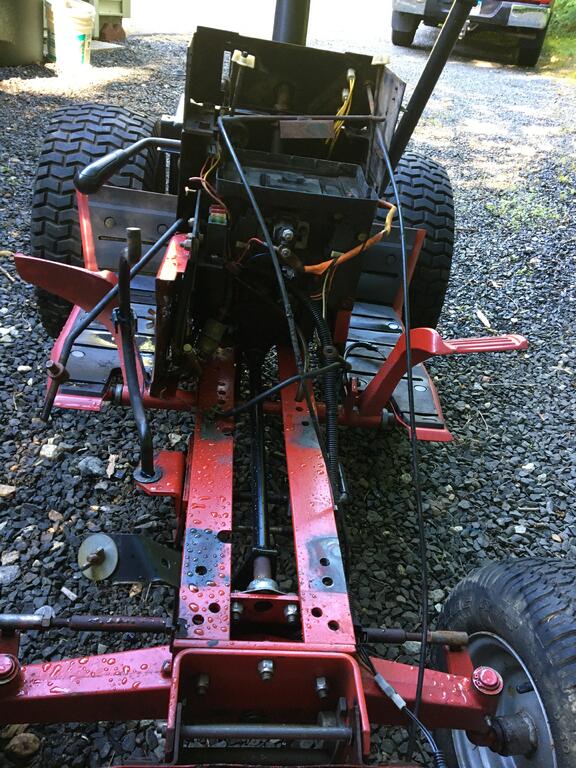

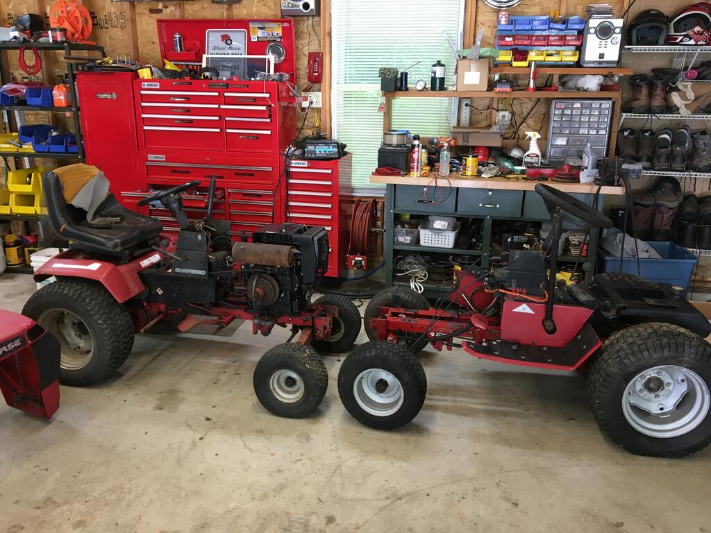

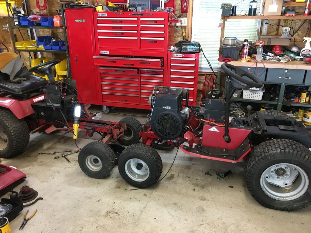

Sparky-(Admin) 24,627 #10 Posted June 19, 2020 And it begins....The heart attack victim is the 314 seen here... Prepped for surgery... The heart donor (312/8)... The semi-sterile operating room... The heart “placed” in its new home... 2 1 Share this post Link to post Share on other sites

Sparky-(Admin) 24,627 #12 Posted June 19, 2020 Was concerned that going from a Command 14 OHV motor to a Magnum would involve all sorts of wiring...but I simply plugged the Mag wires into the harness on the tractor that had the Command motor and it fired right up!! 2 1 Share this post Link to post Share on other sites
WHX?? 54,958 #13 Posted June 19, 2020 No idea what's wrong with the 14? Share this post Link to post Share on other sites
Sparky-(Admin) 24,627 #14 Posted June 19, 2020 On 6/19/2020 at 1:51 PM, WHX24 said: No idea what's wrong with the 14? No idea. It does have tenants that moved in and made a home so the tins need to come off for a proper assessment. I haven’t heard a whole lot of bragging about these horizontal shaft Command motors like I do about the K series and the Magnums so I just charged forward with the swap. Share this post Link to post Share on other sites

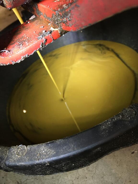

Sparky-(Admin) 24,627 #15 Posted June 19, 2020 No WH has ever left my house (whether sold or traded) with nasty trans fluid. So why does every machine that enters my garage have this same nasty trans fluid ... 2 Share this post Link to post Share on other sites

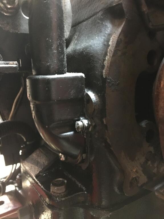

Sparky-(Admin) 24,627 #16 Posted June 21, 2020 Well this project is on hold, was hoping to be driving it around by now. Drained the oil from the Mag 12 and partway thru pouring in quart #2 I see new oil on the garage floor. Seems the gasket between the block and the oil dipstick tube elbow thingy is shot. The screws were all tight ...odd, never seen this before. So waiting for a gasket to be delivered along with a new 7473 belt and the idler pulley for the drive belt. Share this post Link to post Share on other sites
