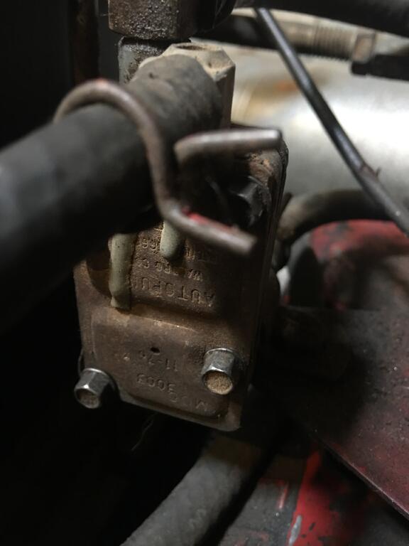

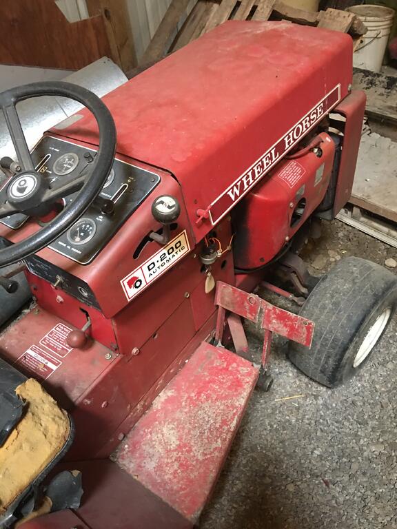

Adam E Miller 0 #1 Posted June 13, 2020 Hello all I am trying to find a new carb and fuel pump (vacuum driven) for a D-200. Any ideas? Share this post Link to post Share on other sites

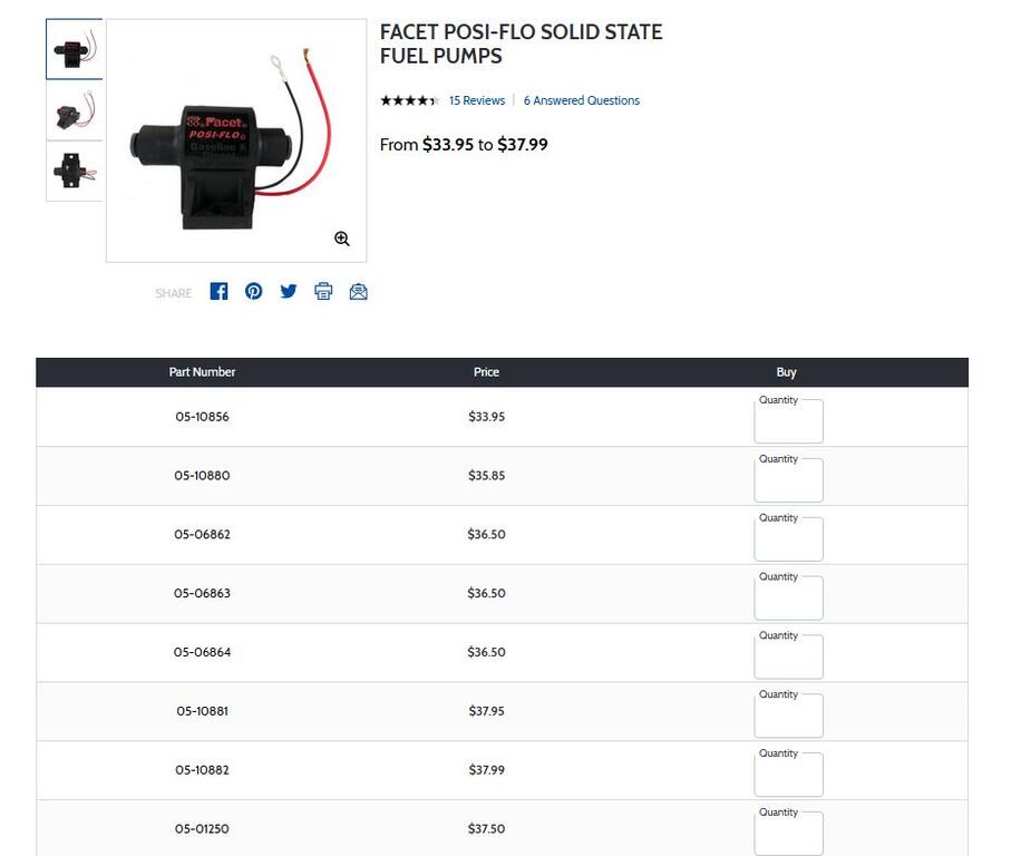

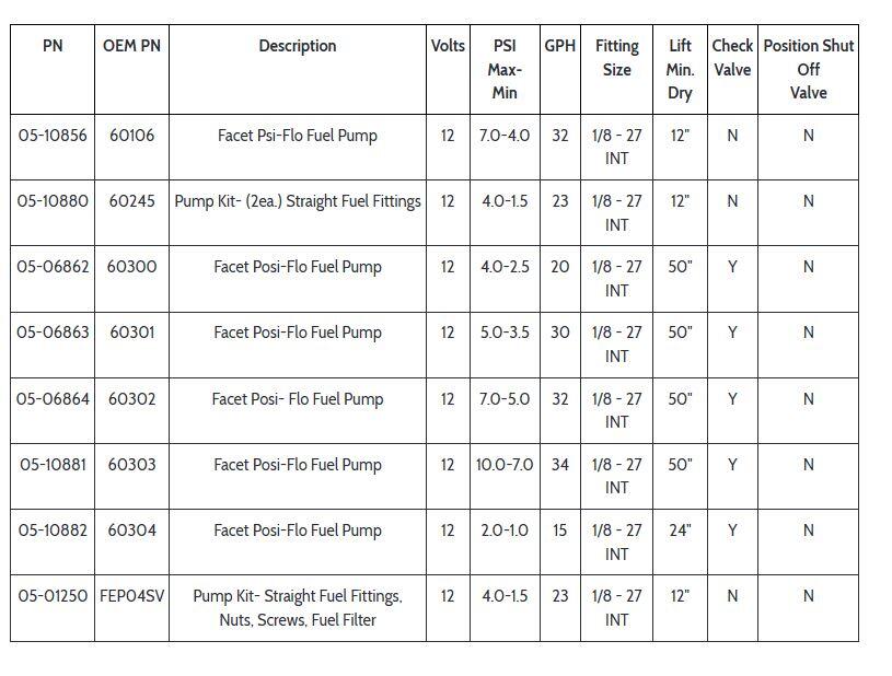

pfrederi 18,969 #2 Posted June 14, 2020 (edited) I would switch to an electric fuel pump. A failing vacuum pump can dump gas into the crankcase. I have had good luck with Facet posiflow pumps. Made in USA. Model 60245 or 60304 A new Kohler card will be hugely expensive. The cheap Chinese knockoffs may or may not work. A careful cleaning and rebuild kit would be my first choice. Edited June 14, 2020 by pfrederi Share this post Link to post Share on other sites
pacer 3,177 #3 Posted June 14, 2020 I agree with Paul, go ahead and just get an electric and that Facet has a good reputation. Anymore I just go ahead and change to lectric on any tractor I buy. Just in case youre hesitant to rebuild your carb there are several of the after market carbs on the bay in the $30 range - just put "k532 carburetor" in search. If you decide on this look closely at the throttle and choke positions on it and see if their positions match your carb. I personally have had good luck with these aftermarkets. This one is shown at $20.95 1 Share this post Link to post Share on other sites
