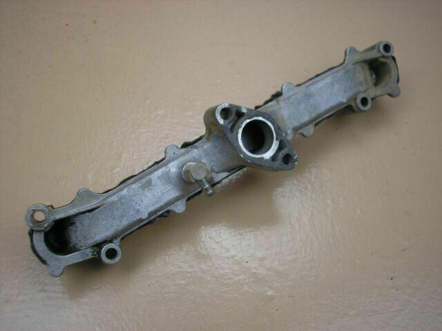

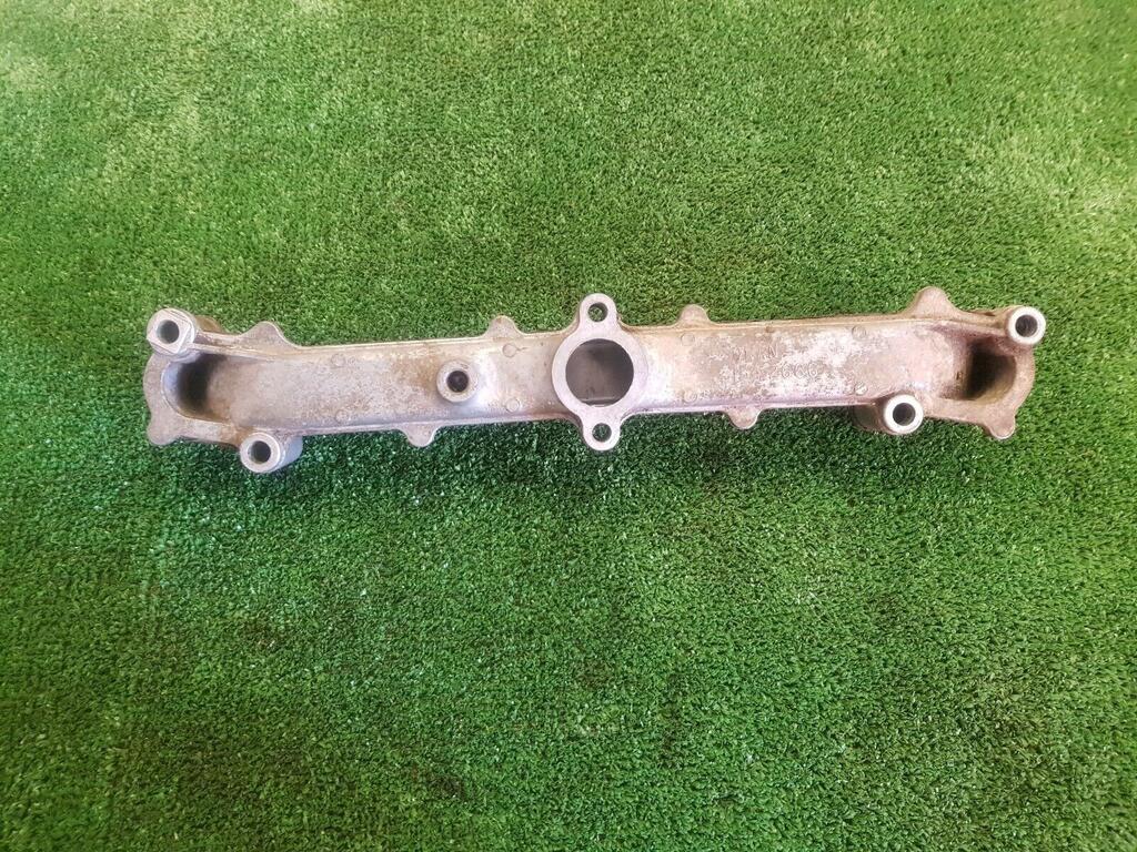

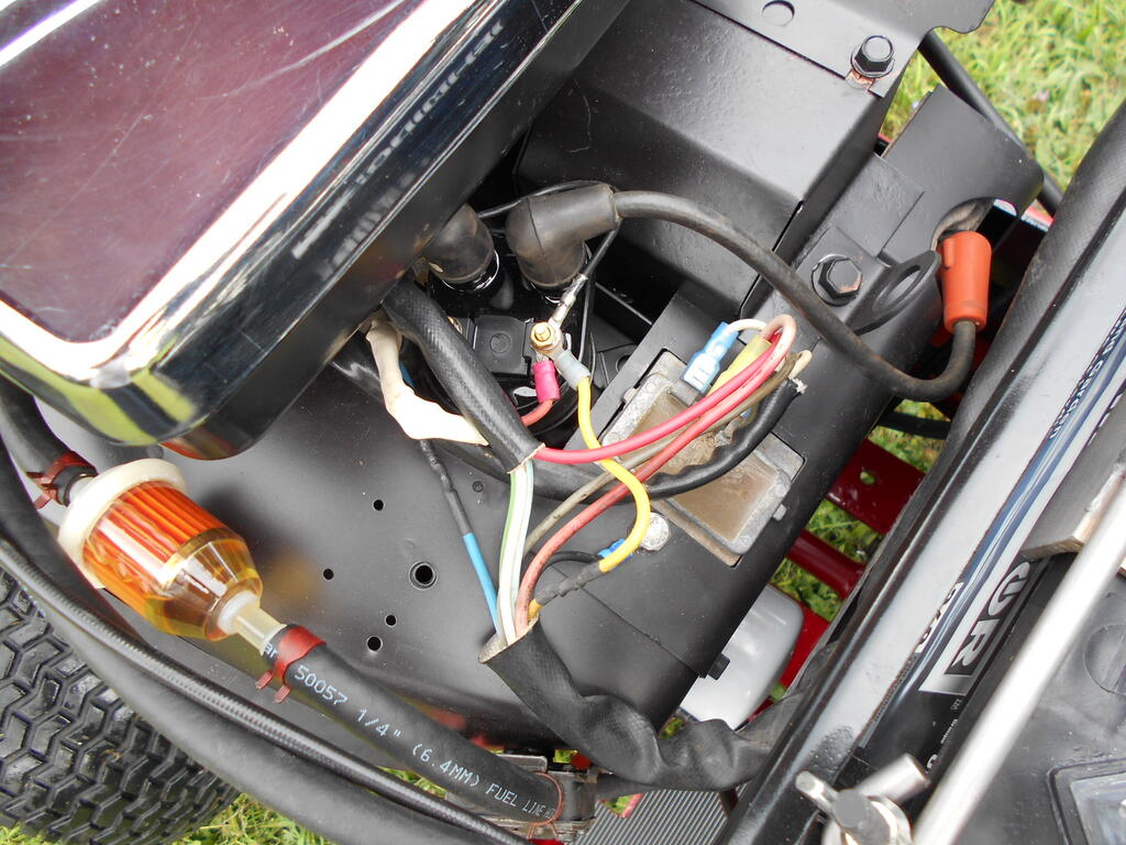

cleat 9,340 #5 Posted June 14, 2020 The signal source for the tach comes from the rearmost of the three terminals at the voltage regulator closest to the battery. You can make it out in the picture below. the front terminal has a single white wire and the rear terminal has both a white wire and the grey tach wire connected to it. Center terminal has the red battery connection wire on it. You will see a raised boss on the top of the intake close to the carb as seen below. This is just in front of the carb. You will need to drill and tap that to fit a 90 degree barbed fitting. Intake will need to be tapped to a tapered pipe thread I am unsure of the exact size but I would think 1/4" The fitting points to the left as sitting on the tractor away from the muffler. I believe it uses 1/4" vacuum line. Share this post Link to post Share on other sites
