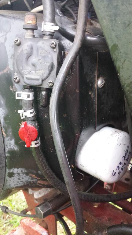

wrightorchid 261 #27 Posted June 25, 2020 (edited) I noticed that there is only 1 screw holding on the fuel pump. My 312 has 2 screws and a gasket. Maybe this is it? Is it possible to just get a gasket if this is it? Edited June 25, 2020 by wrightorchid Share this post Link to post Share on other sites
lynnmor 9,073 #28 Posted June 25, 2020 Get the gasket for around the oil filter to prevent loosing cooling air. The fuel pump has a pulse line on the back side, if it leaks a small amount of oil can come out. Use 1/4" fuel line to replace. The oil filter is on a mount that has a gasket to the block, that can leak. The one screw holding the fuel pump is not causing a problem, but you should replace the missing sheet metal screw. Start soaking any and all fasteners on the engine with penetrating oil. Do this several times a day for as many days you have. The intake and exhaust bolts strip easily, take care removing and installing. Onans need indoor storage. Use only genuine Onan gaskets for the above. Glass bead and paint the muffler with Rustoleum High Temperature paint, these things cost too much to not protect them. 1 Share this post Link to post Share on other sites
