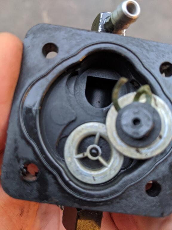

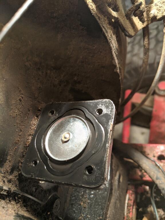

cgambino1018 28 #1 Posted June 10, 2020 newbie here, have a 1988-90 312-8 that sat for 2 years. tried to start it today.. while spraying starter fluid it would run. once i stopped the stream it would die. i got gas going to the gas pump but not out the other end. i took the pump off and this is what i see (see pics). what are my options? do i just order a new pump or try to fix this. seems like the gasket is torn. all help is appreciated. Chris from CT. 1 Share this post Link to post Share on other sites
Alex175 784 #2 Posted June 10, 2020 Top picture it appears as though your check valve is not in where it's supposed to be, it should be seated down in that indent on the top of the picture in the opposite direction of the check valve in the bottom of the picture. One is designed to let fuel in and not back towards your tank, and the other is for letting the fuel out towards the motor, but not back into the pump. I battled this issue myself the last few days, albeit on a slightly different brand pump so it's design was minimally different, but that would need to be reinstalled or the pump won't do anything. As for your mention of the gasket looking torn, if you are referring to your second picture, that is the fuel pump diaphragm, and if that is indeed torn it would have to be replaced as that, in conjunction with your two check valves, is what pumps the fuel. So the long and the short of it is, if there are no tears in the diaphragm and you can reinstall the check valve you should be fine. If the check valve cannot be reinstalled, or the diaphragm is torn, it might be best to get a new pump. Share this post Link to post Share on other sites

cgambino1018 28 #7 Posted June 11, 2020 i put everything back together based on the advice above and it started.. lets see how long this lasts.. wish me luck. Plan B but a new pump. Thanks for all the advice Share this post Link to post Share on other sites
