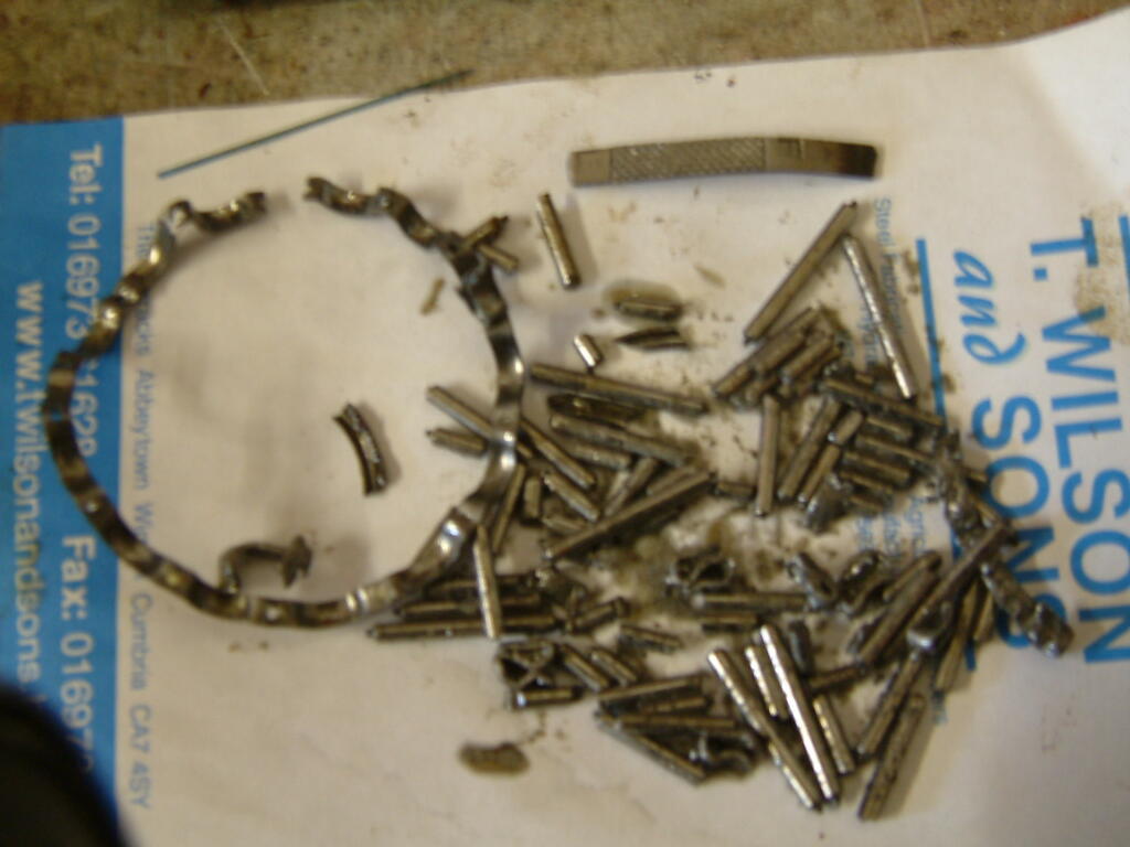

WHX?? 53,916 #8 Posted June 10, 2020 I gotta like yer lingo Norm... knackered... now that is just a plain cool word! I know what yer thinkin Mcalex and it ain't gonna work.. you don't get it all out and needles drop back in yer gonna be sorry. Yer gonna knacker it up some more. Only one way to get them out. You don't haft to have the puller it's just nice. You should press them back in tho ... hammering them back in can ruin them. How's this Norm... @Achto made some really nice hitch pins and he didn't knacker them up! guy couldn't help myself... 4 Share this post Link to post Share on other sites
Stormin 9,987 #9 Posted June 10, 2020 (edited) 6 hours ago, WHX24 said: I gotta like yer lingo Norm... knackered... now that is just a plain cool word! The term knackered comes from Knackers Yard. That's where old, injured, sick horses, cattle go to. Means damaged, worn out, tired. Sometimes think I'm ready to go for it. BTW. On their way into the transmission, the needles severely damaged the main bearing. Knackered it, put simply. Edited June 10, 2020 by Stormin 3 1 Share this post Link to post Share on other sites

Stormin 9,987 #13 Posted June 10, 2020 Black Horses transmission now has metric main bearings. 1 1 Share this post Link to post Share on other sites

71_Bronco 1,072 #15 Posted June 10, 2020 McAlexander, I was referring to the picture that Stormin had posted, with all the bits and pieces of the bearing from his transmission. The the top of the pic, it looks like the end of the dipstick to check the trans-fluid was broken off and swirling around inside. 2 Share this post Link to post Share on other sites

Stormin 9,987 #18 Posted June 10, 2020 If you look at the broken off end of the dipstick, you will see that it is black, just above the F full mark. I think a PO had made one dipstick out of two and that's why the end broke off. Share this post Link to post Share on other sites
