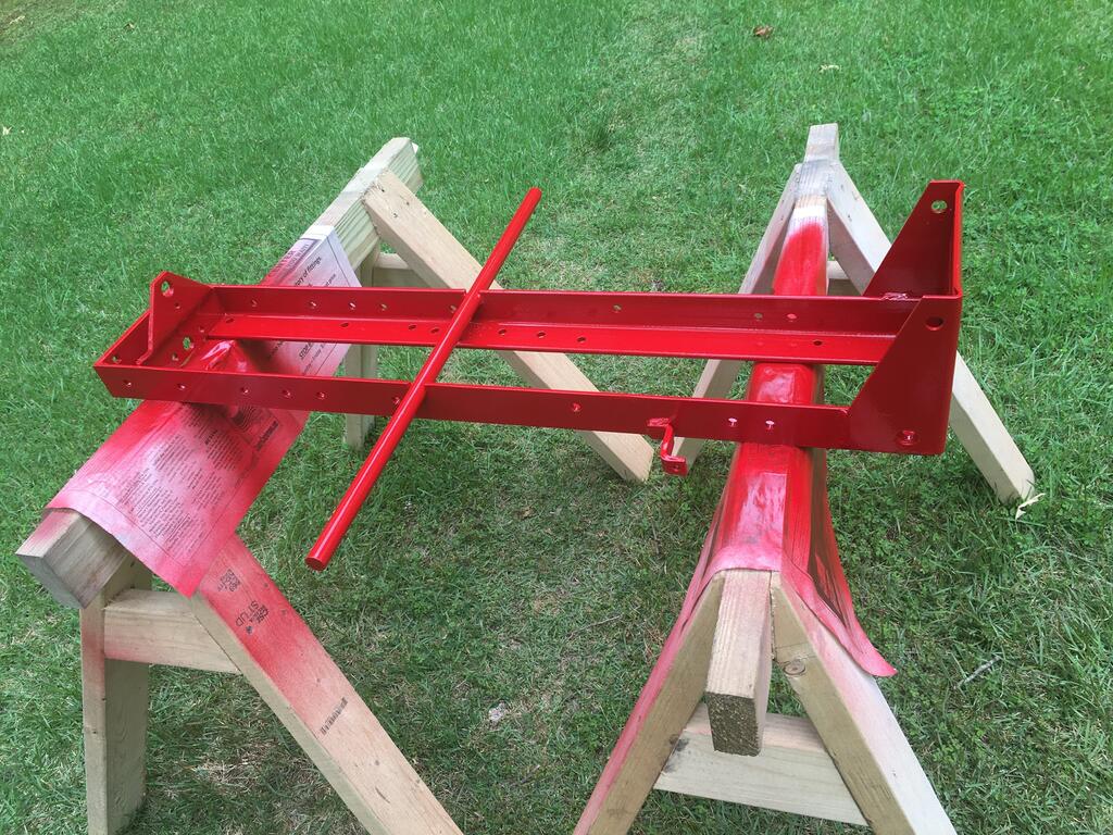

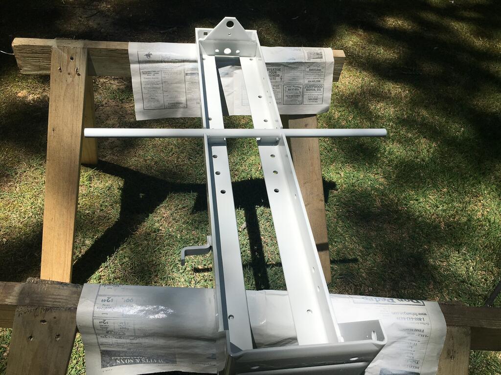

Hello everybody! I have my new frame blasted, epoxy primed,  and painted. I am using this perfect condition 72’ Charger frame that also has the front mount for the mule. My 69’ Electro 12  frame needs extensive repairs due to heavy wear and abuse. The question I have is this. I have both sets of front wheels, 60 Electro, 72 Charger. Looks like the Electro took the NLA 16x5.50-800 tire. The 72’ Charger tire is a 16x6.50-800 tire. The Charger wheels have a different offset, but appear the same width. Which wheels and tires should I use is  the question? I am going to use this tractor regularly for mowing and plowing snow.
