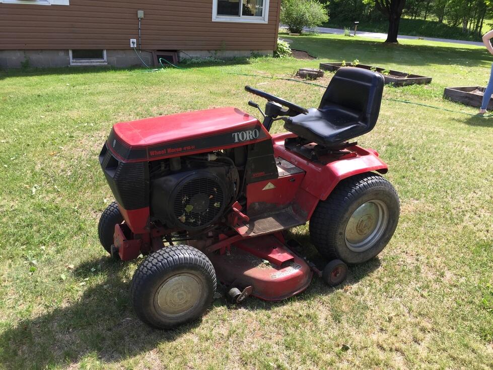

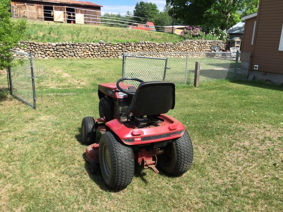

Anthony Wendover 124 #1 Posted June 7, 2020 (edited) So this morning I took a drive to the dump and upon arrival I see a Wheel Horse 416-H sitting in the scrap pile. Walked over and it fired right up! The guy at the dump said the previous owner had enough of it and couldn’t make it drive he was done trouble shooting it. Apparently that went on for two years? Anyway I pushed it right onto my truck and got it home. Transaxle was full of the proper fluid so took belt guard off. There I find the issue a very stretched belt and the wrong spring on the tensioner. He had a small spring as seen on driver side brake band. So pulled that all off put a new belt on it with the proper spring and man oh man this thing cuts and works great. Now here are pictures of her and the beautiful job it did on the grass today. Edited June 7, 2020 by Anthony Wendover 4 16 3 Share this post Link to post Share on other sites
