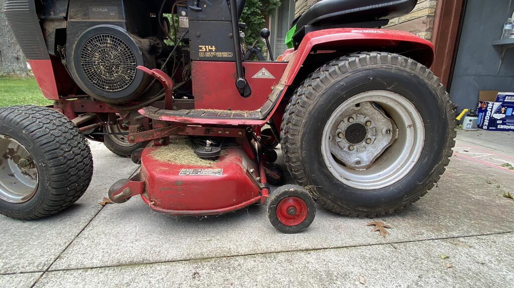

0rnery 7 #6 Posted April 28, 2024 (edited) Same problem with 1996, 314-8 with 42" deck. (Yes, I've downloaded manual.) "'Dial-A-Height" is about 1/4" from highest position. In transport position, deck has rear wheels in highest position, but still roll on the ground. With lift lever lowered, front anti-scalp rollers actually roll on the ground. This can't be right, it cuts the grass at about 1-1/2"'! Almost tempted to cut the grass with deck in transport position, but that's about an inch too high. I suspect the chain that lifts the deck is incorrect, but no idea how it should be adjusted. Same with the rest of the deck adjustments. I think I could cobble this to work correctly in the transport position, but there must be a proper way to adjust it. Is it a given, the deck wheels will be riding on the ground as long as the deck is mounted? If so, that doesn't really seem right either. Bottom line is, I want about 2-1/2" grass height when this is over. TIA, John Edit: Just started wondering if lowering the deck would actually only be for pulling it off the tractor, despite what Owner(s) manual says? Instructions say, "Move lift lever forward to lower attachment." Well, that's pretty generic... It applies to all "attachments". Might not be correct for this deck? Edited April 28, 2024 by 0rnery Share this post Link to post Share on other sites
