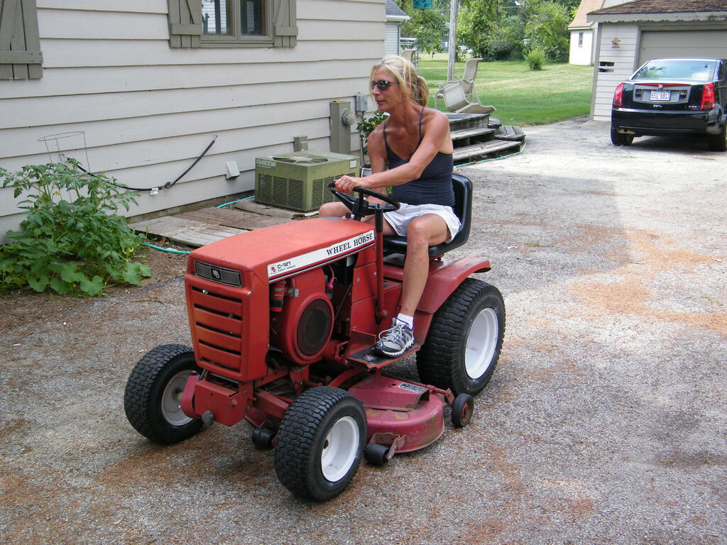

jellyghost 378 #1 Posted June 6, 2020 Hello! I have been using my C-101 for about five years, and it usually runs well without any choke. I only use the choke when I first start the engine. The past few times, it seems to need a little choke or it will die sometime during the mow. It is not repeatedly dieing. I have a marine squeeze ball on my fuel line. After a few pumps, the engines starts back up, but it does not run for long. The air filter is newish and looks good. ? Share this post Link to post Share on other sites
