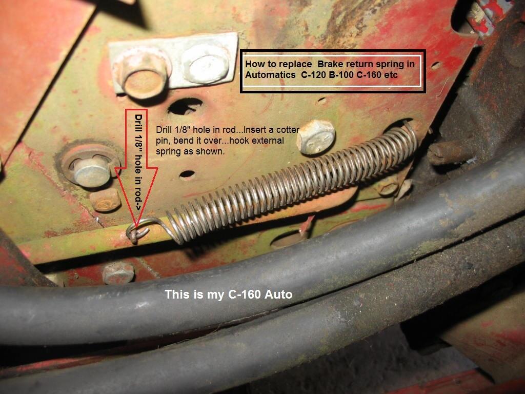

daveoman1966 3,881 #3 Posted June 6, 2020 Here is my solution.... Did this about 6 years ago and is the perfect fix... Just drill a 1/8" hole in the soft steel rod and mount the return sping on the outside of the hoodstand. This is my C-160 Auto... Easy peasy fix. 2 3 Share this post Link to post Share on other sites
ebinmaine 75,770 #4 Posted June 6, 2020 7 hours ago, daveoman1966 said: Here is my solution.... Did this about 6 years ago and is the perfect fix... Just drill a 1/8" hole in the soft steel rod and mount the return sping on the outside of the hoodstand. This is my C-160 Auto... Easy peasy fix. Nice. I put this post in my Charger Hydro thread to remind me to use the idea. Thanks Dave! Share this post Link to post Share on other sites
squonk 44,866 #5 Posted June 6, 2020 Did the same thing. Why it wasn't done that way from the factory is mind boggling. 1 Share this post Link to post Share on other sites

c-series don 10,781 #7 Posted June 6, 2020 Thanks guys for all your responses! I’m going to go with Dave’s method and mount the spring on the outside. I actually thought about but didn’t see a good way to mount a spring. Now I do! And now it’s fixed!👍🏻 2 1 Share this post Link to post Share on other sites

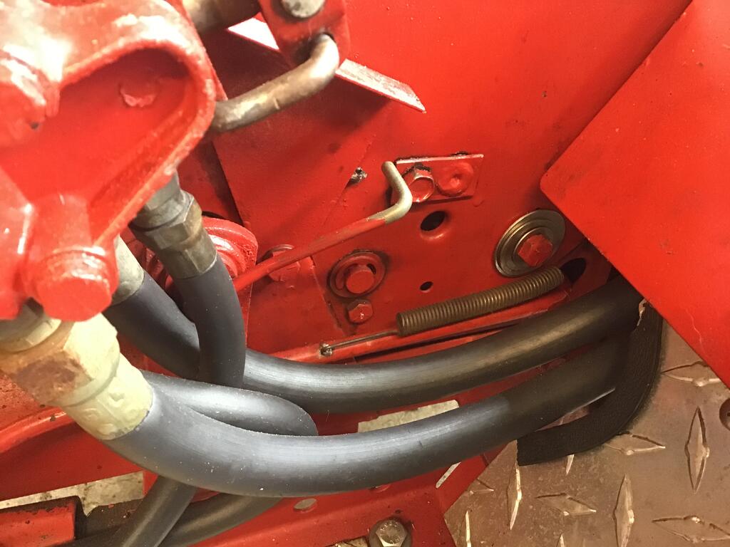

squonk 44,866 #8 Posted June 6, 2020 I used a hose clamp to attach the spring to the pedal arm on mine. Been there for 12 yrs. now. 3 Share this post Link to post Share on other sites
