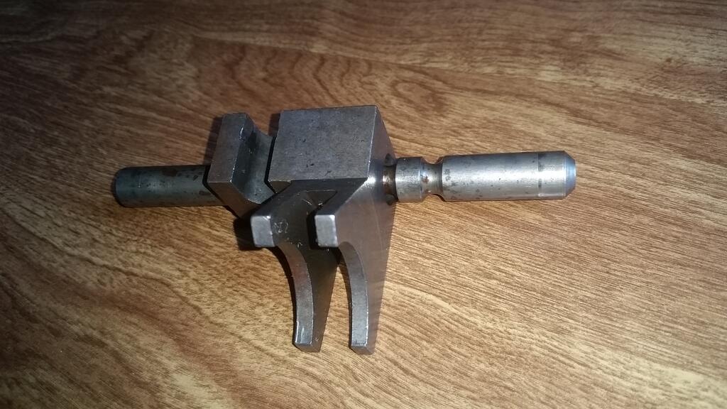

tntatro 181 #7 Posted June 15, 2020 I bought some gears and shifters from a 421 and case halves from a 417-8 and the gears seem to fit okay so far but I have this one gear left over. Anyone know what it is? Did I miss something or did the seller accidentally give me a gear from a different transmission? I haven't bolted the transmission together yet, just put the gears in to see if they fit okay. I had to order a detent spring, shift pin and some thrust washers. Share this post Link to post Share on other sites
