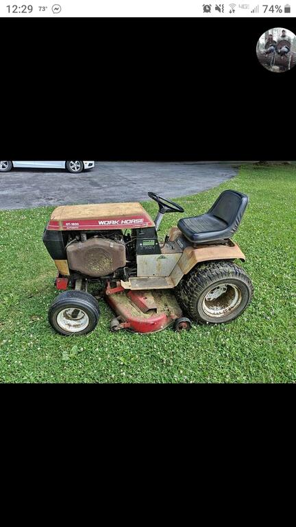

Going to look at this Work Horse this weekend. It's a GT1800. Comes with a 48" SD, and two 42" decks. One SD and one RD. Also comes with new transmission filter and NOS muffler. Guy wants $450 for it. Seem like a fair deal? Guy claims it runs and mows great. Also, what's the difference between a GT1800 and a GT1848?
ebinmaine
I can't help you with the model number difference but if it runs drives and cuts with a solid transmission that's a very fair price.
Pullstart
Play your cards right, and you could offload some of the extras for an even better deal!
Goldnboy
If you go my thread in the restoration section "GT1848  refresh" you can see a worst case look at a GT1800/GT1848 a hidden item to check is the frame to seat mounting for cracks which seem to be a weak spot on 300/400 series.
c-series don
There’s no difference between the 1800 and the 1848. In 1982-83 it was an 1848, 18hp with a 48” mower deck. In 1984 it was an 1800 offered without a deck.
