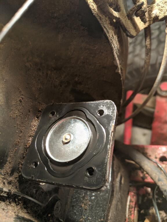

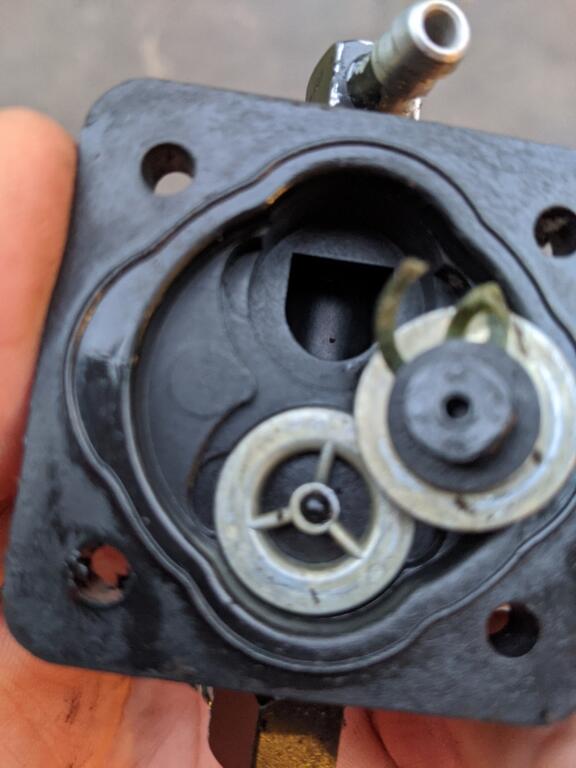

cgambino1018 28 #20 Posted June 10, 2020 newbie here, have a 1988-90 312-8 that sat for 2 years. tried to start it today.. while spraying starter fluid it would run. once i stopped the stream it would die. i got gas going to the gas pump pump but not out the other end. i took the pump off and this is what i have (see pics). what are my options? do i just order a new pump or try to fix this. seems like the gasket is torn. all help is appreciated. Chris from CT. Share this post Link to post Share on other sites
