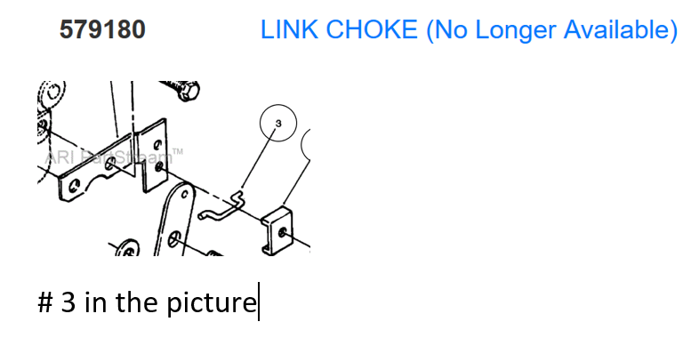

ljcollinsvt 1 #1 Posted June 5, 2020 Can someone please help me with the following. I am looking for the dimensions for the Short choke link on a P220 Onan engine. I have been told that they are not available and if I am given the length it is only a mater of putting in a couple of z bends in the right place to make one out of a piece of wire. Thanks Share this post Link to post Share on other sites

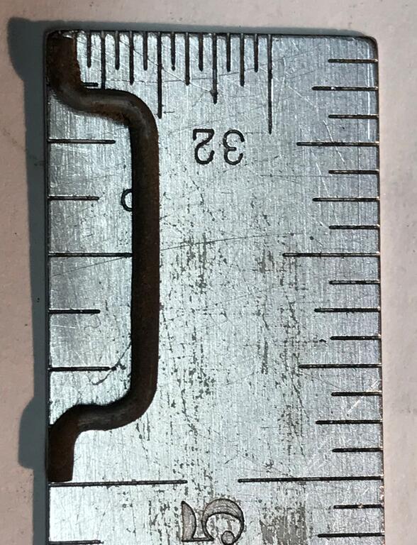

lynnmor 8,079 #2 Posted June 5, 2020 Sorry about the delay. The wire is .057" diameter. 1 Share this post Link to post Share on other sites
ljcollinsvt 1 #3 Posted June 6, 2020 LynMor Thank you for this information, you have saved me a great deal of aggravation, I was sure that I would have to bend up at least 3 of these to narrow down the correct bends. Share this post Link to post Share on other sites
