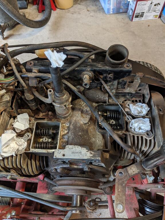

chex313 123 #3 Posted June 3, 2020 (edited) Keep the cylinders cleaned....and at some point you can check the compression. The valves do need periodic adj. There are couple of threads that are recent,(because I just had to do it) on the subject. If you can use a feeler gauge it will cost you less than $75 including , compression gauge, and gaskets and feeler gauge. If its running good you may have a couple 100 more hours (or more) till its becomes an issue. You only need to pull some tin , exhaust and intake manifolds and that will give you excess to the covers for the springs and adj. It will look like this for adj Edited June 3, 2020 by chex313 added info Share this post Link to post Share on other sites
lynnmor 8,557 #4 Posted June 3, 2020 Valve adjustment is at 1,000 hours. I would service the air filter, change the oil and filter and replace the spark plugs. Make sure that the grommet that seals around the oil filter is in place, they often are lost. While the oil filter is off, use a flashlight and mirror and look up at the fins, if you see much debris or oil residue, clean that out. This is a miserable job but you need to keep that area clean to prevent a loose valve seat. Usually they are clean, I have one with 1400 hours and it never accumulated enough to matter. While mowing, the screen accumulates a lot of clippings, so brush it off in a way that doesn't send the clippings inside. Change the transmission oil and filter now. Grease the chassis often, particularly the pivot for the front axle and the fittings pointing straight front at the ends of the axle. Jack up the front to do these three fittings so the grease flows where it is needed and flushes out the debris. These axle points are plain bearings and you don't want wear there. I hit them almost every time I mow. Most everything you need to know is in the manuals available on this site. Share this post Link to post Share on other sites
