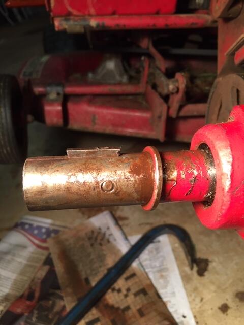

RedRover 27 #1 Posted June 2, 2020 I finally removed the hub from my 312-8 in order to replace bad axle oil seal.....The key remains tight on the axle.....Obviously, the key will need to be removed. What is the best way to remove the key? Share this post Link to post Share on other sites
WHX?? 52,842 #2 Posted June 2, 2020 (edited) Just take a sharp cold chisel and start at the outside edge and keep working it back and forth. Penetrants help soak it. You will ruin the key but it's expendable... just a #15 woodruff. I'll send you a new one need be. Careful axle is not. You got the hub off the battle is almost won. Bad news here is grab a hold of the axle and see if ther is up and down movement. If ther is let us know. Edited June 2, 2020 by WHX24 1 Share this post Link to post Share on other sites
8ntruck 8,124 #3 Posted June 2, 2020 You might want to take a flat stone or a fine file and remove any material that was displaced by the dimple the set screw made. This will make it easier/safer to install the new seal and probably the hub, too. 4 Share this post Link to post Share on other sites
JoeM 8,820 #4 Posted June 2, 2020 spiral one layer of electrical tape starting at the seal area out to the end of the shaft. That will keep the key or defects in the shaft from tearing the new seal. Putting a little grease on the seal helps with installation. 5 Share this post Link to post Share on other sites
ebinmaine 74,409 #5 Posted June 2, 2020 I've read about folks that have had to use a tiny little die grinder and cut those keys out. I have not had to do that yet. I have had a couple fight me tooth and nail. What I've done is to support the axle directly under the key with something like a pile of wood blocks or a jack stand. Blocks preferred because they're soft. Take a small hammer and tap each end of that key like you're trying to make it do a seesaw motion. often after a few hits in each direction you'll be able to detect minuscule movement. Supporting the end of the axle makes it so you can get a little more ambitious with the hammer if need be. When you go to reinstall the seal, very carefully check the edges of the key slot. They can be razor sharp. deburr that a little bit. Flat file works great. For tape I have used both electrical and Scotch. I only put a thin stripe over the key way. You should only have about 1/16 of up-and-down movement. Less is better. If there is more than that you could put it back together and run it but you'll be back in there before too awful long because the wheel bearing is worn. 3 2 Share this post Link to post Share on other sites

71_Bronco 1,072 #8 Posted June 2, 2020 I recently had one that was stubborn for me. I hit the key back and forth (see-saw motion as described), but only minor movement. I used the chisel method next, didn't budge. Tried vise grips and tapping them with a hammer, but the vise grips slipped off. Yes, liberal ammounts of penetrating oil was used. I finally got it out by using a little map-gas torch. Heated up the axle a little (didnt change color), and then tried the cold chisel. That worked, and was able to slowly pop it free. 1 Share this post Link to post Share on other sites

RedRover 27 #11 Posted June 2, 2020 14 hours ago, WHX24 said: Just take a sharp cold chisel and start at the outside edge and keep working it back and forth. Penetrants help soak it. You will ruin the key but it's expendable... just a #15 woodruff. I'll send you a new one need be. Careful axle is not. You got the hub off the battle is almost won. Bad news here is grab a hold of the axle and see if ther is up and down movement. If ther is let us know. Hello again.....there is slight movement up and down...more than 1/16" as one within the forum mentioned. I think the reason you wanted to know is because the needle bearing is "shot". After draining the oil fluid, I used a small magnet to fish out several pieces of the bearing and a few pieces of the complete needle bearing unit....Now what? Fortunately, I have a next door neighbor that is a "whiz" at this type work.... Share this post Link to post Share on other sites
ebinmaine 74,409 #12 Posted June 2, 2020 Looks like you're going to need to pop that transmission out of there and do some bearing replacement. There are lots of good threads on this site and quite a good many of us who have been there. It's surprisingly simple to get into one of these transmissions. Wheel Horse parts and more which is one of our vendors will have all the stuff you need. A lot of the bearings and seals are available at good aftermarket parts stores as well. Removing it from the tractor will be basic nuts and bolts. Take a few pictures. Just keep asking questions and jump right into it. 1 Share this post Link to post Share on other sites
