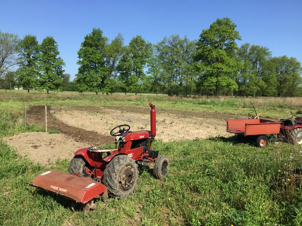

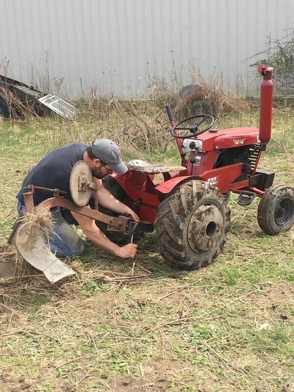

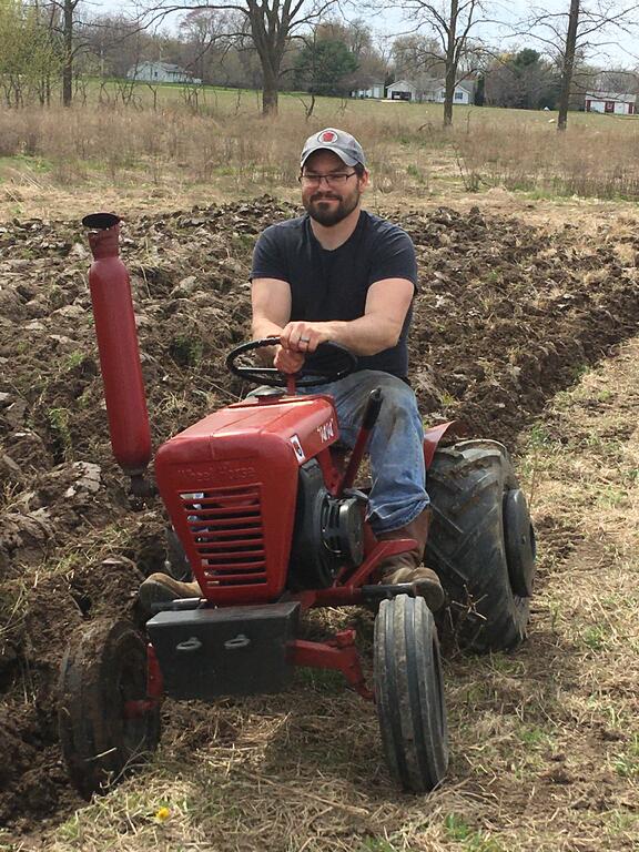

Pullstart 68,414 #12 Posted May 31, 2020 (edited) I put an 8 speed with 1-1/8” axles from a ‘78 C-101 on my 502 I call Putt Putt. I wouldn’t change it for the world, unless I get up the gusto to put in the era correct freshly rebuilt 6 speed with limited slip on my shop floor into it! Edited May 31, 2020 by pullstart Couldn’t add pics... 2 1 Share this post Link to post Share on other sites
