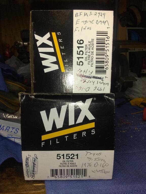

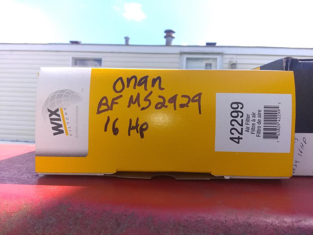

bottjernat1 2,196 #1 Posted May 29, 2020 (edited) Thanks for all the help everyone! For those folks just getting into the wheelhorse hobby or folks who have been trying to find right part numbers. Here are the filters needed for a 1976 D 160 with a bf ms 2929 Onan motor. I bought the proper air filter engine oil filter,and transmission filter. Edited June 1, 2020 by bottjernat1 2 1 Share this post Link to post Share on other sites

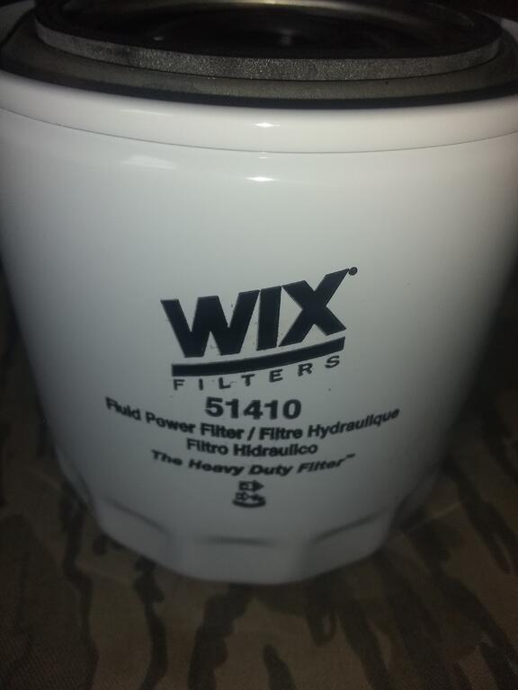

squonk 45,511 #2 Posted May 30, 2020 That 51516 is an Ford engine oil filter. Should be 51410 or Napa 1410 2 Share this post Link to post Share on other sites

pfrederi 19,878 #6 Posted June 1, 2020 (edited) The filter for the transmission should be 51410 or Napa 1410 Edited June 1, 2020 by pfrederi 1 Share this post Link to post Share on other sites
bottjernat1 2,196 #7 Posted June 1, 2020 (edited) 38 minutes ago, pfrederi said: The filter for the transmission should be 51410 or Napa 4140 So is this filter just designed for hydraulic fluid? The 51410? Because i had lots of folks tell me i got the right one. and according to everything i looked up online this was also the number it transferred to. Just wanting to see why and if im wrong im wrong. I am a ok with being wrong. I can always go exchange it. Edited June 1, 2020 by bottjernat1 Share this post Link to post Share on other sites
squonk 45,511 #8 Posted June 1, 2020 1521 is a Chrysler engine oil filter . You want the 1410 or 51410 2 Share this post Link to post Share on other sites
bottjernat1 2,196 #9 Posted June 1, 2020 3 minutes ago, squonk said: 1521 is a Chrysler engine oil filter . You want the 1410 or 51410 Also want to add I am using what the factory manual says 10w30 or 10w40 oil. And that is what is in it now is engine oil. When i first drove it it sounded good and the tranny was working as it should. Share this post Link to post Share on other sites
squonk 45,511 #10 Posted June 1, 2020 The 1521 has a bypass valve which you don't want. It will work but can be an issue if something happens down the road. I worked in auto parts for 10 years and have been a mechanic for 30. The information in parts catalogs, interchanges computers ect is only as good as the person who put the info in.Mistakes are more common then you think 2 Share this post Link to post Share on other sites

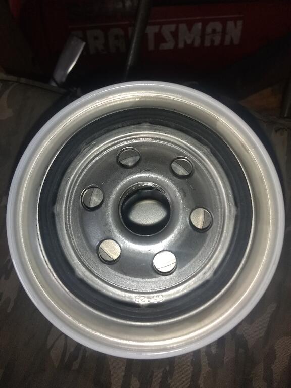

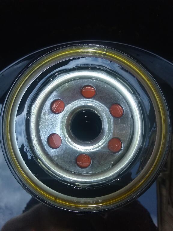

bottjernat1 2,196 #11 Posted June 10, 2020 Well you all must be correct on the transmission oil filter mine keeps leaking super slowly but its leaking! I will go today and pick up the wix 51410 and see if that cures it! Does it matter i am not running tranny fluid in it? I used what the book called for 10w30. I ask because the filter you all want me to use says hydraulic on it? atleast online anyways. Thanks and I will update if it cures my issue! Share this post Link to post Share on other sites
bottjernat1 2,196 #12 Posted June 11, 2020 Ok iI got the filter changed to the 51410 It so far seems to be doing good. Thanks for all the help everyone. Here is my last video on the beast till i get a snow plow and get to push some serious snow! Share this post Link to post Share on other sites
bottjernat1 2,196 #13 Posted June 11, 2020 Also wanted to share the difference between the filter i bought originally 51521 and the 51410. The old new one i bought first then the new one. Share this post Link to post Share on other sites
