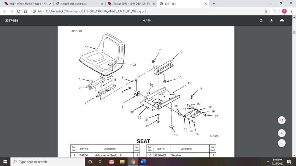

Depending on the year of your 416 the seat switch may be inside the seat foam padding (1992 and newer I think). If the seat is not in good condition the switch can become a bit touchy, had that problem but a new seat cured it. Part # 23 in this drawing.
