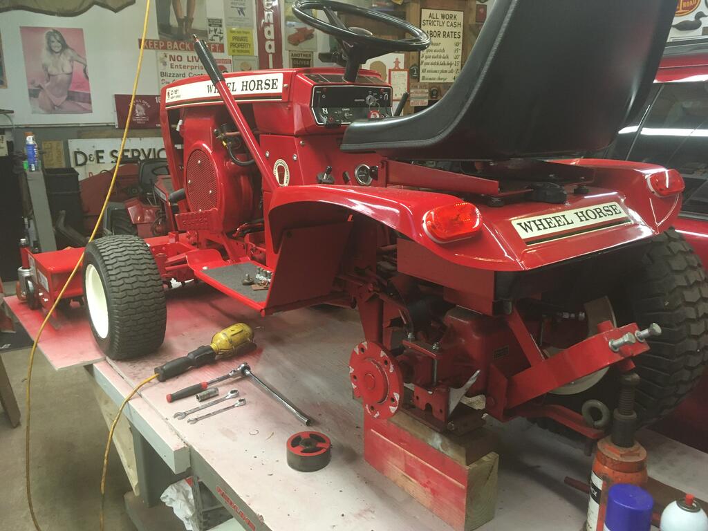

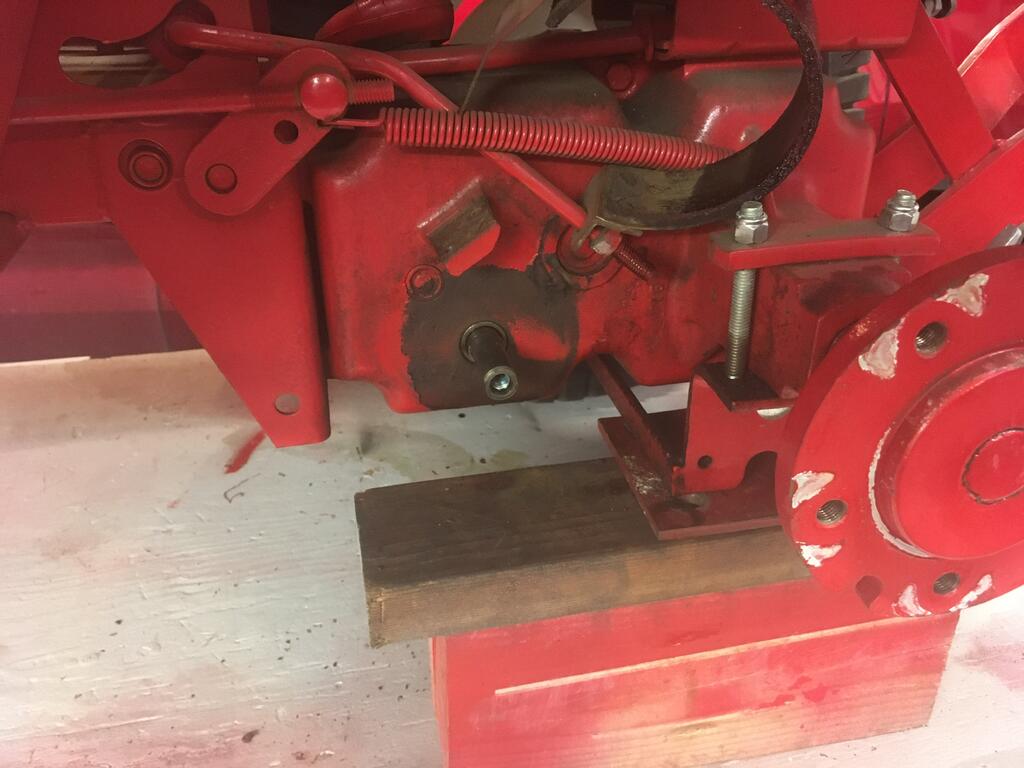

Mikefeds 15 #1 Posted May 28, 2020 While changing the brake band I noticed excess fluid around the Brake drum bolt. I did not remove the drum, but hopefully thinking it's just the oil seal. From what I can see from research so far, seal replacement seems straight forward, part is available, PN 100441. That being said, and not being a transmission expert, it this task as easy as it looks or should I combine the task in the off season and have the wheel seals done as well by my Wheel Horse Equipment dealer ?? Also, have seen comments about replacing it with another metal based seal rather than the replacement one.....thoughts ?? and suggestions for easier removal of old seal if I'm going for it !! I read somewhere about bleeding the system too afterwards ?? Thanks for any input ...... BTW all transmission seals are original...... :(....... Share this post Link to post Share on other sites
ebinmaine 74,515 #2 Posted May 28, 2020 That should be a fairly easy job to do especially where that seal has already been leaking. That gear oil is a good penetrant so the drum will likely come right off. I think there's just a bolt in the end of it that holds it on? On our horses we do use metal seals. I like the way they set in place better. If you look at the top of the transmission section there should be a thread that says something about bearing and seal part numbers cross. There are several different places to get seals or bearings when needed. Lots of parts stores can cross the number. Several places online. One of our vendors called Wheel Horse parts and more has them as well. I'm really not at all sure where you're reading about bleeding anything. There's no place to do anything like that on these transmissions. You'll be in good hands with the folks on this website if you want to go ahead and tackle it yourself. It's a fairly straightforward repair. 2 Share this post Link to post Share on other sites
c-series don 10,551 #4 Posted May 28, 2020 I just did it on my C-161 and it was very simple. I used a dental pick to pull the old seal. 1 Share this post Link to post Share on other sites

Mikefeds 15 #15 Posted July 27, 2020 So ebinmaine, I went and drained the transmission, pulled the brake drum, and low and behold, the original oil seal was nonexistent. Cleaned it up, pushed in the new seal refilled the tranny and off it went. you said the brake drum would come off easy.... understatement, it literally came off with no resistance from the gear oil. thanks for the support and guidance On this project ! 1 Share this post Link to post Share on other sites
