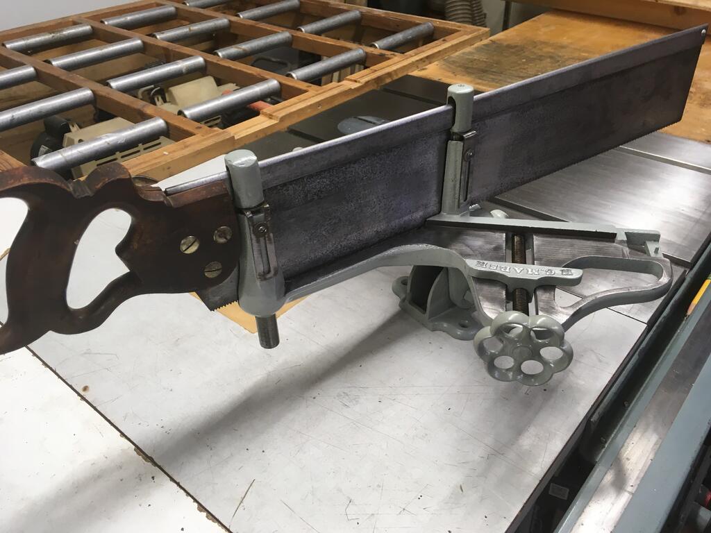

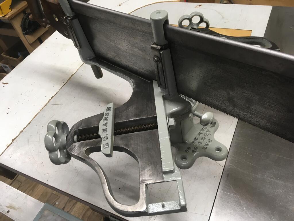

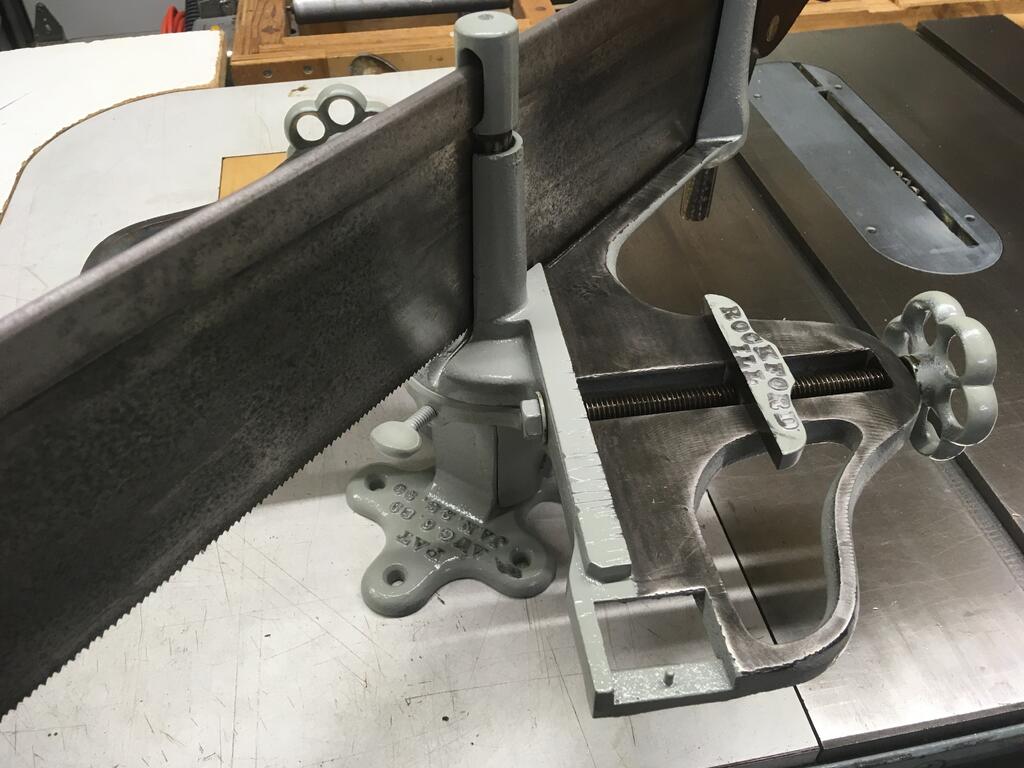

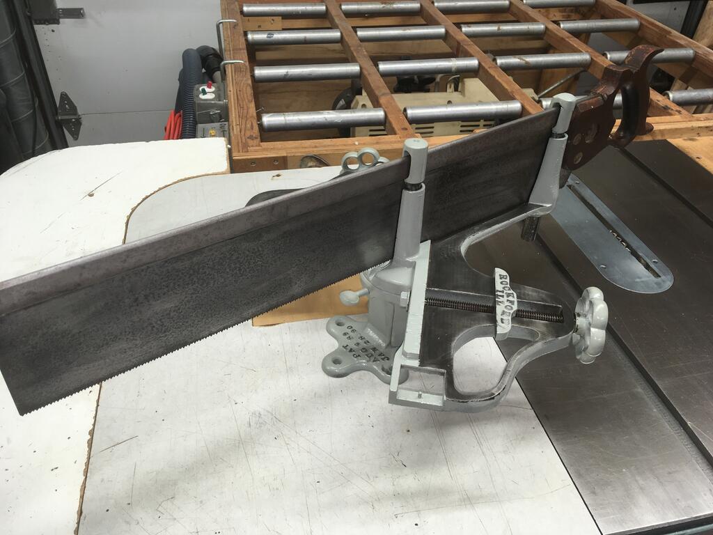

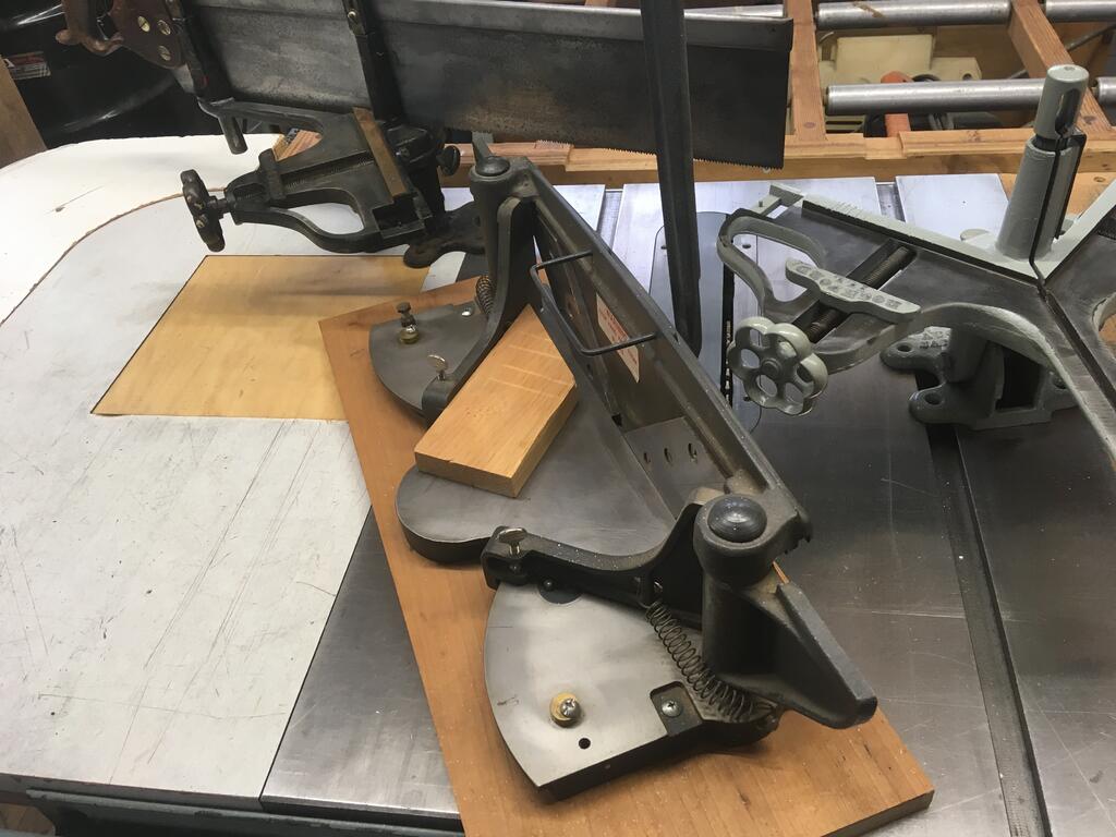

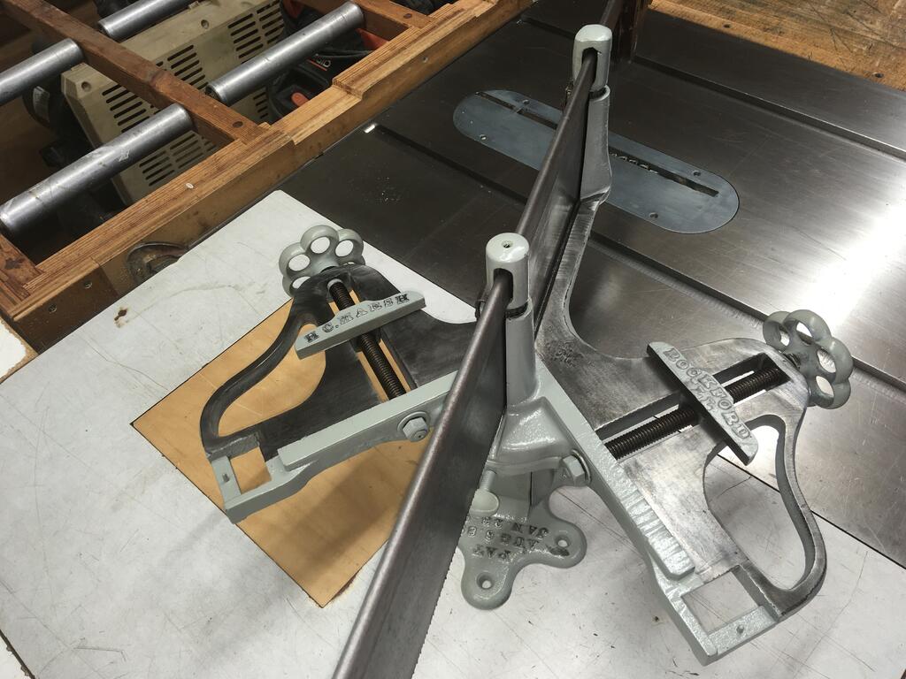

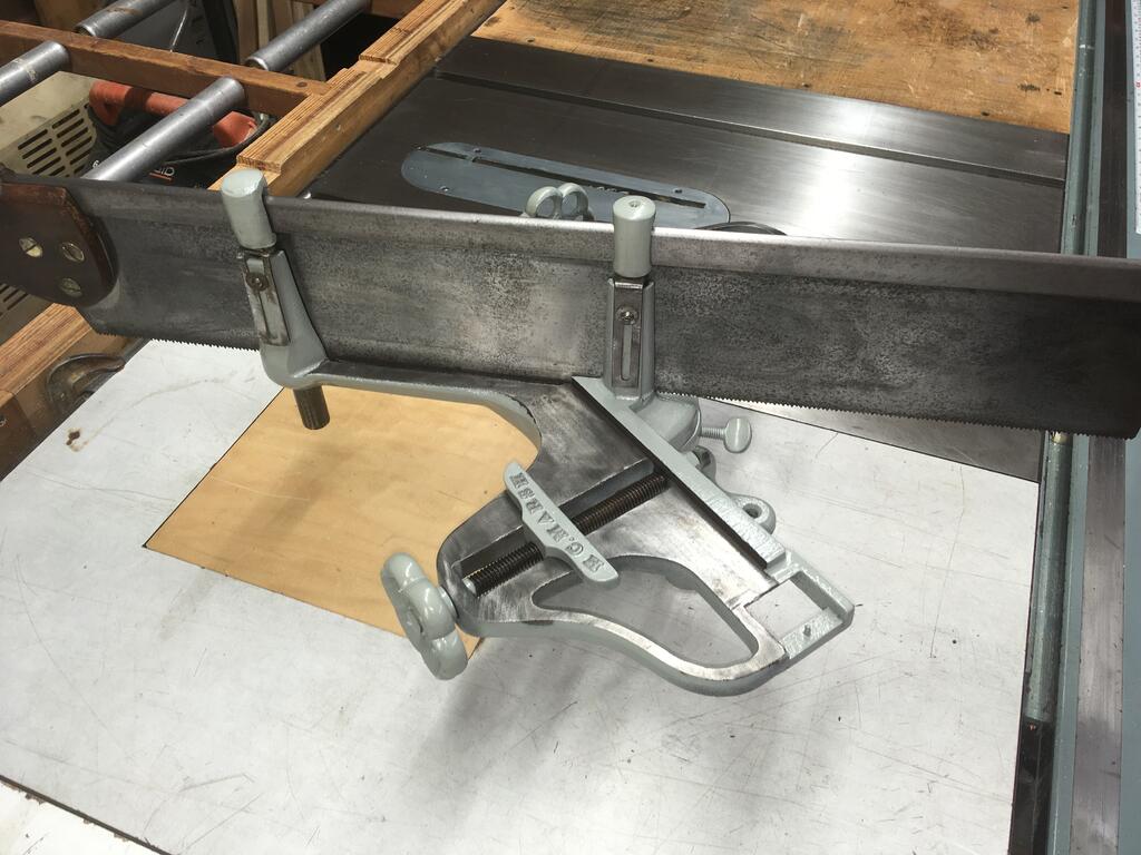

formariz 12,358 #1 Posted May 27, 2020 (edited) Did a little restoration and tuning to one of my favorite tools. It’s a very early Marsh Miter Clamp and Saw. These are with no match when doing any frames such as picture frames. About 120 years old and as effective as the day it was made. Four of them are used . Three without the saw feature are used to clamp first 3 miters and on last one ( the one that always gives you trouble) one cuts through joint on both pieces simultaneously creating a perfect miter with this one. One then just moves pieces together and clamps until glue is set. If any fasteners are used they are used while its clamped . Edited May 27, 2020 by formariz 5 4 1 4 Share this post Link to post Share on other sites

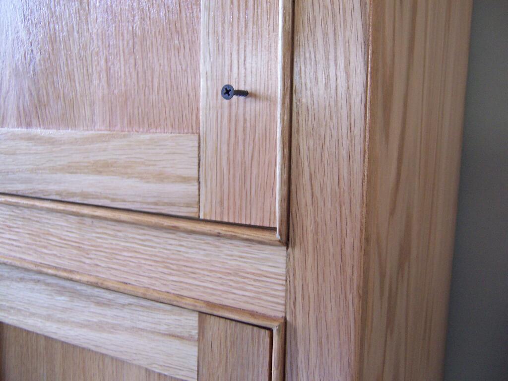

953 nut 64,611 #7 Posted May 27, 2020 I have one just like it an must agree that it is one of the finest tools I own. I used it to miter cut the half-round moldings for a set of utility room cabinets and they fit perfectly. The oak was harvested from our property while we were clearing for the new house. 4 1 Share this post Link to post Share on other sites

formariz 12,358 #10 Posted May 27, 2020 (edited) I have always been sort of amused watching others try to make frames. It’s always a frustrating affair.Most of the time you cannot ever get all four miters to fit 100% correctly. Every time you take a tiny bit out of one it changes the whole thing. The first 3 are always relatively easy to do but its the last one that always gives you the most trouble since any error on the others its tripled on the last one. The secret to easy perfection all around is this tool. With the other 3 clamped and glued, one cuts through the joint on the fourth miter with this tool creating a perfect joint once pushed together. I have two of these and two regular ones without the saw, this way I also have the option of adjusting a second joint if needed. Miters are first rough cut with another miter saw and then cleaned out with a "guillotine". Edited May 27, 2020 by formariz 1 Share this post Link to post Share on other sites

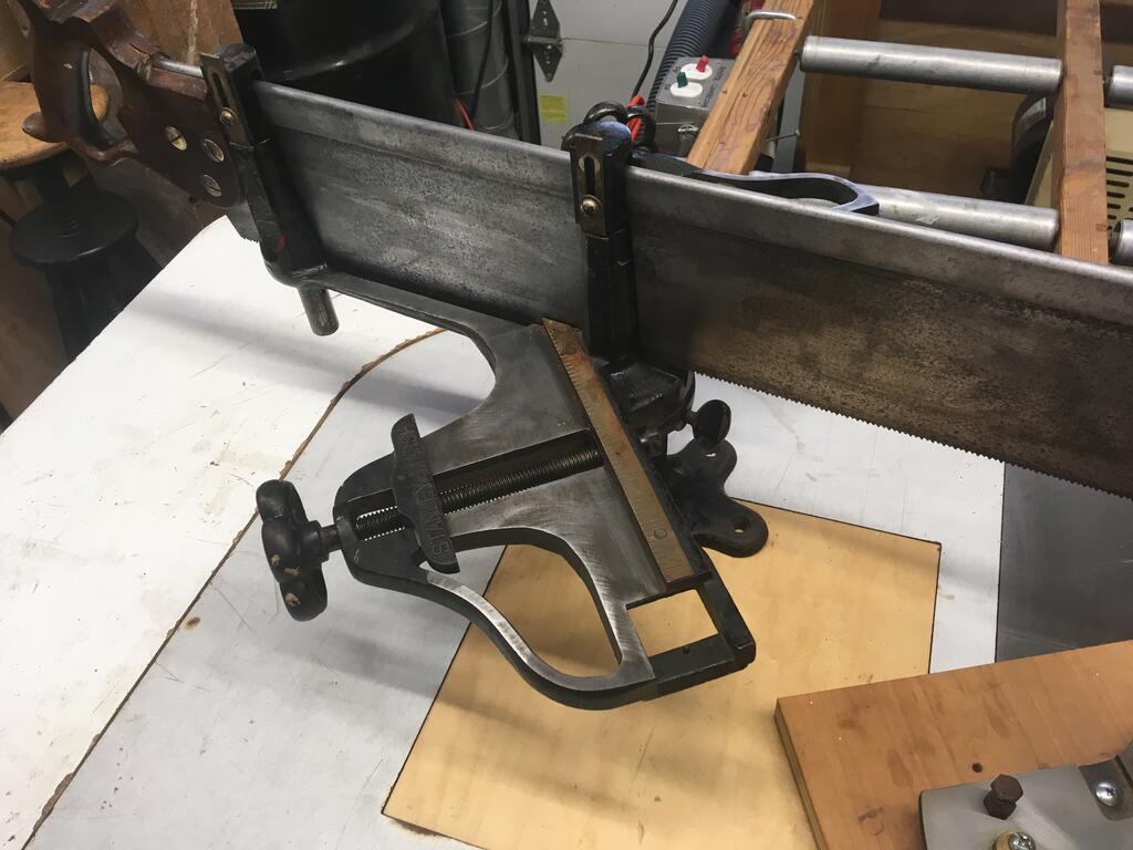

formariz 12,358 #11 Posted May 27, 2020 (edited) 9 hours ago, Mickwhitt said: Similar tools today are flimsy and made of monkey metal. A pale immitation of the cast iron beauty we see here. Such a shame that tools are now made not to do the job but to a price point and for convenience of the tool company. There is a machine at a local museum and the stand is made of cast iron, but it has Queen Anne style legs with claw and ball feet just like a fine table. It's just a wire forming machine and has no need for such ornate legs, but they did it because they could and were proud of their products. These days it would be pressed steel. Our local foundry is now a housing estate, forced to close by cheap foreign goods, lost forever. Progress is what they call it. Mick Very true. Change however happens quickly. Although both units on photo are of high quality, second unit (black one) is about 5 years younger. Stanley bought Marsh about then. Units were then manufactured in a much larger quantity. Although castings are about the same, actually a bit better on the later Stanley, and there are improvements on it which make it better to use and more reliable, they act totally different. The original Marsh is an absolute pleasure beautifully smooth in all aspects where the Stanley is a bit rough in usage. The Marsh even has some defects from factory which were addressed there with some carefully made repairs.I guess they could not afford to just discard it. There is just another level of care on the manufacturing of the Marsh.I always find interesting on how quickly things change once productivity and profitability becomes a factor. Edited May 27, 2020 by formariz Share this post Link to post Share on other sites
