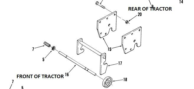

wheelwhores 107 #1 Posted May 26, 2020 I don't understand how this thing works. Is mine installed correctly? Is it just the weight of the deck pulling down on the two little notched plates that holds it into the mechanism? Feels like it should lock more secure somehow. Share this post Link to post Share on other sites
wheelwhores 107 #3 Posted May 26, 2020 Is the set of plates with he round notches supposed to be flipped the other way so we the spring pin is push it can swing down to lock the bar of the deck lift bar into place? Share this post Link to post Share on other sites

gwest_ca-(File Mod) 12,015 #6 Posted May 26, 2020 Take one side plate off and turn item # 17 around so the longer arm is on the left side. Garry 3 1 1 Share this post Link to post Share on other sites
squonk 45,609 #7 Posted May 26, 2020 Yup Garry nailed it 2 Share this post Link to post Share on other sites
wheelwhores 107 #8 Posted May 26, 2020 Gary that is what I was seeing too....thanks for confirming. I've found a bunch of little things like this on the machine the first owner never had right. Share this post Link to post Share on other sites
wheelwhores 107 #9 Posted May 26, 2020 thanks for these diagrams they are super helpful...all the manuals for the mower decks were too grainy for me to really see what the setup was supposed to look like. I think this is enough for me to get it on correctly. Thanks guys. Now i just have to get my grease point problem fixed and i should be ready to go. Share this post Link to post Share on other sites
