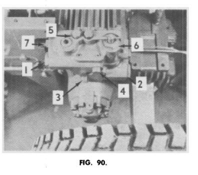

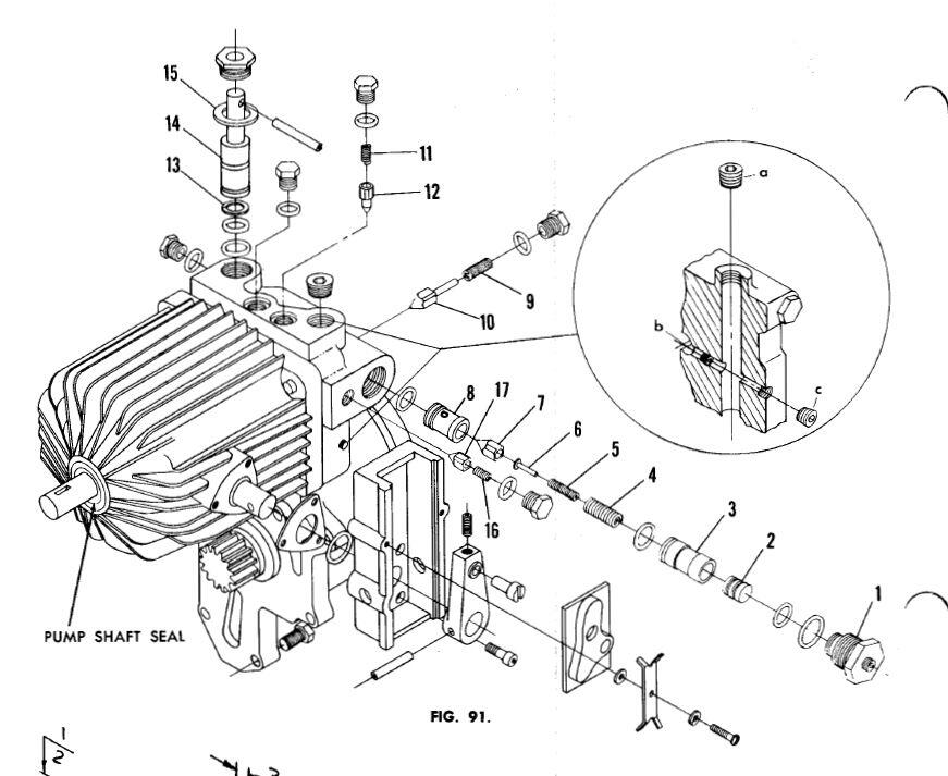

pfrederi 19,520 #6 Posted May 28, 2020 On 5/26/2020 at 9:06 PM, sdotzel@yahoo.com said: Cylinder ram does not move. All linkage is good. Is the implement relief valve spring in the lift control valve or the transmission It is located in the hydrogear pump head Download the service manual here. Share this post Link to post Share on other sites
