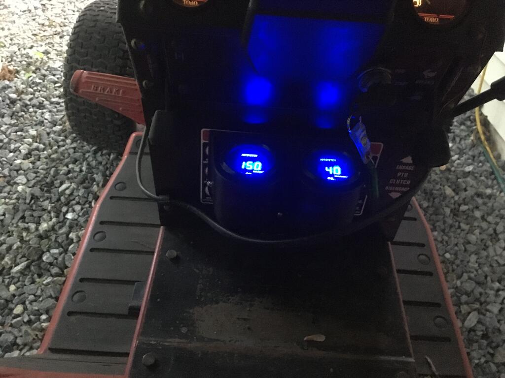

formariz 12,354 #12 Posted May 25, 2020 Could be something wrong with sensor also. I switched to a gauge so this way it can be monitored accurately. Its pretty interesting on what causes temperature spikes or for it to rise. Outside temperature has a lot to do with it also. With gauge you can tell if it is going to the point where it will break down the oil which is I believe 250F. On a hot day mowing for over an hour mine never passed 160? Share this post Link to post Share on other sites

Adams94 1,069 #16 Posted May 25, 2020 2 hours ago, lynnmor said: Grab the plastic fan and see if you can turn it by hand, I had one slipping although the bolt felt tight. They used red Loctite on the bolt making it fell tight but had almost no pressure on the plastic fan. That is the only time the temperature light ever came on and the transmission sure was hot. I will do that 4 hours ago, EricF said: Might sound like a silly question, but is the plastic fan on backwards? Try taking it off and flip it around, see if you get better air flow over the hydro unit's fins. I thought about that. I may try that as well 4 hours ago, pfrederi said: FWIW The temp gauge WH use on the D series (Sunstrand) Showed white 100-200 then yellow from 200 to 250 then Red I like that idea 4 hours ago, formariz said: Could be something wrong with sensor also. I switched to a gauge so this way it can be monitored accurately. Its pretty interesting on what causes temperature spikes or for it to rise. Outside temperature has a lot to do with it also. With gauge you can tell if it is going to the point where it will break down the oil which is I believe 250F. On a hot day mowing for over an hour mine never passed 160? Where did you mount your gauge. I did work my c195 this afternoon on the 3 point disc for prolly half hour. And the filter felt just as hot as the 520 so I’m kinda wondering if a new sensor would help Share this post Link to post Share on other sites
formariz 12,354 #17 Posted May 26, 2020 1 hour ago, Adams94 said: I will do that I thought about that. I may try that as well I like that idea Where did you mount your gauge. I did work my c195 this afternoon on the 3 point disc for prolly half hour. And the filter felt just as hot as the 520 so I’m kinda wondering if a new sensor would help 1 Share this post Link to post Share on other sites
